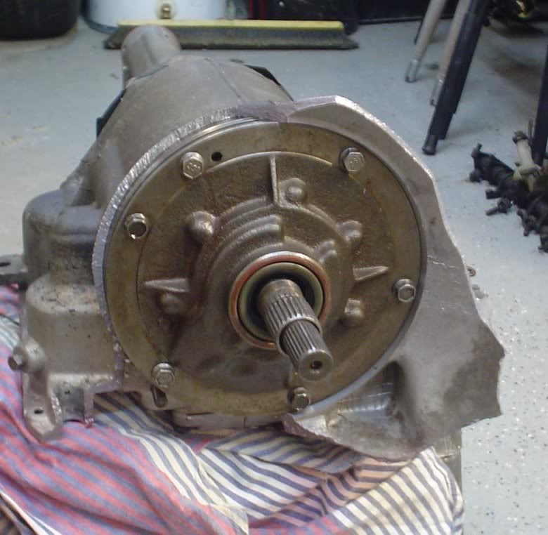

Hi All!!! A little Mopar **** for you all. My 360/904/8.75 Combo. After a Distasterous 1st time at the track...... I lost a frt u-joint cap @ 80 Mph causing a major vibration, to cause this:
The Trans http://i163.photobucket.com/albums/t316/Eric_S68/Ebay080.jpg

Now 4 or so months later it's all back together. New Trans Case, just swapped internals they were all fine. Added a 2.74 1st gear set and a 4.2 ratio apply lever to Trans, New Aluminum Driveshaft, New B&M Pro Ratchet Shifter (Shifter I had was Junk) and a mini starter.
