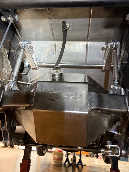

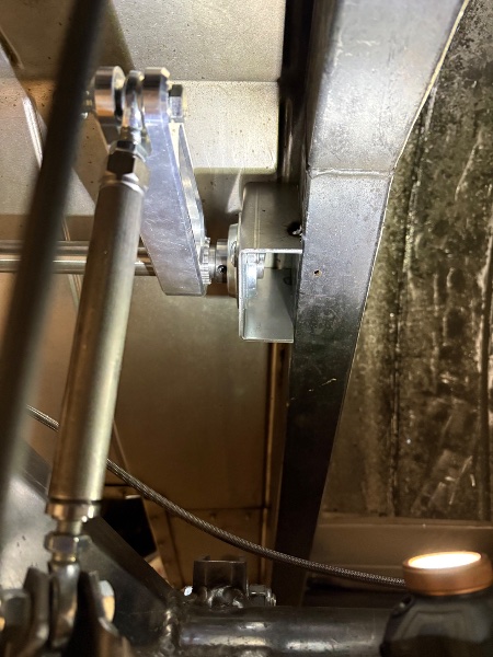

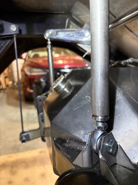

I did a quick mock up yesterday to see how it was going to fit the best. Should be ok this way, might have to tweak it a bit before welding it all in place.

Any way to put the arms more centered over or at least partially on the axle tubes? They tend to work better there as it won't try to twist the housing from the leaverage. Not really a huge deal, but I've seen them get twisted setup the way you have it.
i don't think so, maybe 1/4 inch more outwards is all i can get. i can take a better picture tomorrow
I could cut down the brackets that hold the bearings to gain some width. Not sure if that would help or not.
The width isn't as big an issue as they are spread apart pretty much as wide as you can get it. Having the arms centered over top of the axle tubes is what I'm talking about. Right now they are behind the axle tubes and attached to the back brace. Again not a huge deal but if you look at the faster cars they are on the axle tubes, at least partially if they can't be all the way on the tubes.
i can change that. not a big deal, thanks for pointing it out. first time doing this.
I agree, the further they are spread apart, the more effective they are.
