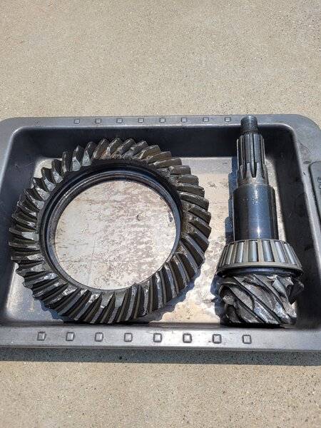

Apparently I was wrong when I said I got the car to dead hook once before. I found a good piece of asphalt and the car hooked for real this time, picked up pretty good, and took off harder than ever... then ~50' later the all too familiar sound of parts breaking came! Oops!
I'll chalk this up to $4!+ happens. My dad had bought this 3rd member used and I just put new bearings, seals, and clutches in it, double checked the pattern, set the bearing preload, and all *seemed* well (I've set up a few dozen ring & pinions before.) For all I know, it could have come out of a bazillion horsepower car.
Since I'm buying new gears anyway, I'll go to 4.30's since that's what my dad really wanted. It should help a tiny bit with reducing wheelspin off the line (which may not be a problem afterall!) and it'll give a little more wiggle room with rpm if the car ends up running faster than I've been planning for.

The rapid loading and unloading of the sprag is what can hurt them. There is no true way to tell without pulling it out. I rolled a sprag. It cracked the case in boss where the sprag sits. It crushed all the springs and posts and broke two rollers in half lengthwise. I had to press the drum out because the rollers were jammed tight. If it would have released, it would have exploded. I back off the line because it was acting funny. It the drum is allowed to freewheel, it will spin approx 2 1/2 times engine rpm. Don’t play around, pull it out and check it. It is NOT hard to pull the guts out and look at it. Dont be intimidated by a 727. To access the sprag you will only disturb two settings. The bands, which are easy to adjust. Everything else comes out as components that can go right back. Pictures pictures pictures as it is before you pull parts out.

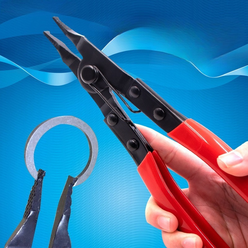

From other guys and what I've read there is NO WAY, from that damage, that I would NOT inspect the trans, the sprag. You don't need all that much to get to the sprag in tools. Biggest thing is a pair of flat nose external ring plier for the big ring in the tail housing. That is the one under the small external cover. Sometimes you need something to work the pump loose. Some guys just loosen the pump bolts and then bang the guts against the pump or prying against the drum inside from the pan opening.
Make sure you get a pair of pliers with enough opening range, I have one that "don't." Sorry, I don't remember what those were.
