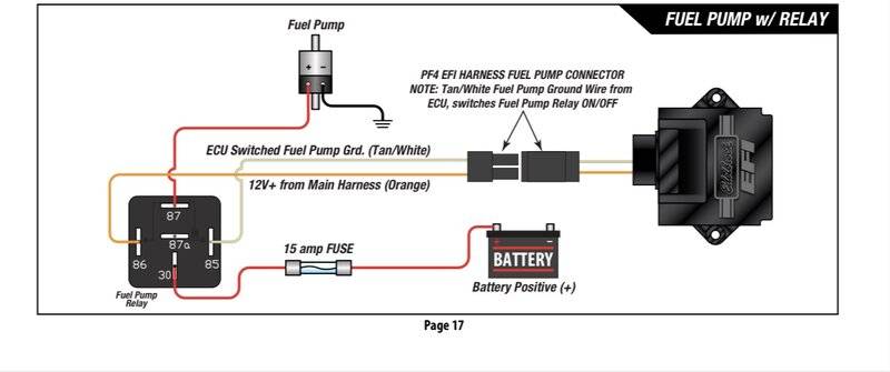

I'm adding Edelbrock ProFlow 4 fuel injection to my 68 Cuda so I bought a new tank from Tanks Inc that's setup with a return line and everything. ...I have the electric fuel pump plus I got an access door for future issues.
I'm about ready to install the tank and wanted any tips or advice anyone may have....

The ProFlo4 can only handle 10 amps of current on the fuel pump wiring. Use that wiring to trigger a relay using a separate circuit fed from the battery to feed the fuel pump.
I used a Summit brand 10 micron fuel filter in the feed line which I used #6 feed and #6 return.
If you’re running fuel with any ethanol I would use the braided PTFE lined hose. I used fittings and fuel hose from Fragola also available at Summit.

I wired in both a low pressure oil pressure switch and a hidden 12V bypass switch to bypass that low oil pressure switch to address priming the system prior to start up.
You might also want to attach a Holley Hydra Mat to your fuel pickup tube, so your system is less likely to have cavitation issues when you get to the last few gallons of fuel in your tank.

+1 on the PTFE hose. Install -8AN (1/2”) if the tank and everything else will accept it. That will give you room to grow if you decide to turn up the powers. 10 micron filter before it hits the injectors.
I also second (third?) the recommendation for PTFE-lined hose. Not only will it tolerate any fuel you want to run, it is smaller in outside diameter than the "usual" braided steel line.
