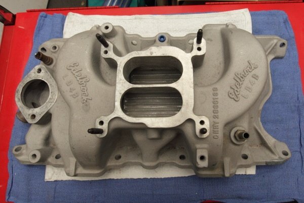

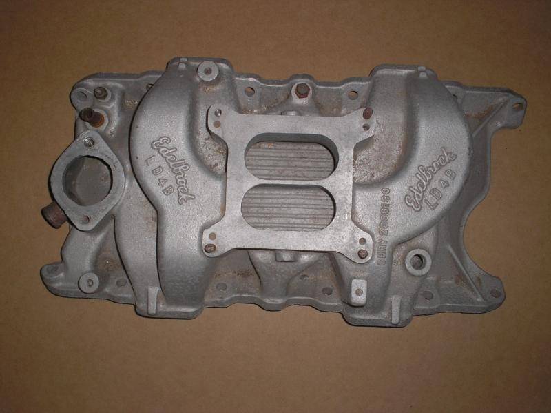

> Can you spot the difference in the Manifolds ?
#LD-4B
[URL="http://www.forabodiesonly.com/mopar/attachment.php?attachmentid=1714505625&stc=1&d=1336971697"][/URL]
#LD-340
[URL="http://themopardude.com/image/43596489_scaled_320x240.jpg"]
[/URL]

The runners are reversed, the LD4B doesn't have the "notch" in the plenum divider, and the LD4B doesn't have mounting bosses for the coil.
