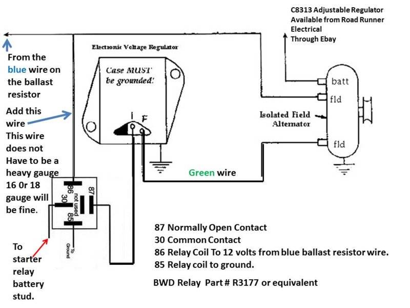

I isolated the field/regulator from the ignition run circuit and placed it on it's own relay powered circuit (relay triggered by the original field feed). It works great.
I isolated the field/regulator from the ignition run circuit and placed it on its own relay powered circuit (relay triggered by the original field feed). It works great.
CFD244 -what is the purpose/benefit of this modification?
My charge voltage was a little higher (14.8v) than I'd like due to minor voltage drop in the ignition 1 circuit. This corrected that issue without putting the ignition circuit on a relay. @67Dart273 has been a proponent of this for years.....and, he knows his ****. :)
