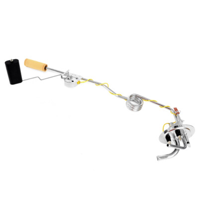

Let me know what you do for a fuel tank and fuel level sending unit.
@ProjectBazza , yes 200s's where call daisy mags or coke bottle spoke mags , do to the shape of the spoke . but american used that spoke ease were as well . this magnesium rims are in a libra design with four spokes those are a can am rim , i have a pair of 13x6 to match up with these 15x18 , but a have a few sets and sizes of vintage american rims in alum alloy and magnesium .
Can put in the Fuel sending unit from the 1985 D100 pickups, they had 2 barrel carbs and manual fuel pumps on the trucks in thoses years. Badically a straw and a gas gauge float.
Can get them on ebay for the 20 gallon or the 30 gallon tanks 2 different send units.
Here is a simple sending unit to check out >
Not without the tank. Look at the size difference in the 89 pump/ sending unit and the carbureted truck sending unit.
Good thinking. I will have to score a used 20 gallon "Factory Plastic Tank" from the earlier '85 era Ram trucks to have on hand.
I had to get one for one of my sons trucks a few years ago, interchange is 81-87
I am pretty sure you can simply swap to earlier rotors to get the 4.5 bolt pattern on the front, with no modifications to the brakes. 82-85 rotors maybe? I would think you could do the same with axles and rear brakes. I'm putting an 8 3/4 from an early 70's truck under my 88, but I'm keeping the 5.5 bolt pattern. A few years ago, I got a pair of 8 3/4 truck axles with the 5.5 bolt pattern from @Righty Tighty and will just swap the brakes from the 9 1/4 I'm taking out. Same backing plates and offset. I'm having to go the other direction on the gas tank, to get one that will accept a pump compatible with the MPFI on the 5.9 Magnum going in. You may be able to just modify the tank you have by disabling the pump and straight piping a new pickup while leaving the gas gauge sender in place.
You can take the TBI pump out of the modular assembly that drops into the tank and plumb a piece of fuel line in its place to drop into the bottom of the well of unit. Add a sock filter to the bottom. Helped do this before on several of the TBI trucks.
PHR Sock Filter With 3/8 Barb Fitting
Sounds like a good idea, use the Original Gas Tank and Keep the Original Gas Gauge when switching over to manual fuel pump setup.
