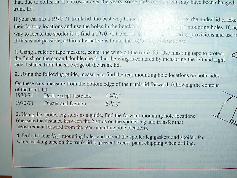

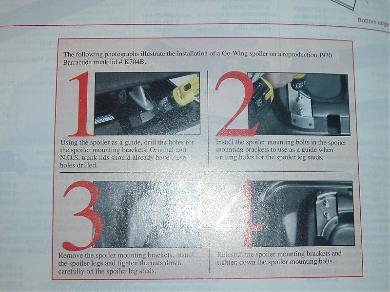

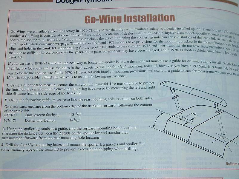

I have this if it helps any.
Jump all over that one Burntorange70 :-D
I have this if it helps any :toothy10::toothy10:=D&gt;:thumleft:
My car didnt come with one from the factory so I will have to cut and drill everything. The chart helps me on where to mount would still like to find out the distance inbetween the pedastles.
I'm sorry, I saw this thread late last night, I was going to get those dimensions for you (I forgot).
The ones that Burntorange70 posted do appear to be correct, I can verify for you tomorrow.
As far as the distance between the pedestals, use Burnt's "B" dimension, multiply by 2, then substract that amount from the full width of the trunk lid.
The remainder will be the distance between the pedastals.
12 9/16" (12.5625) x 2 = 25.125 (12 1/8") minus trunk width...
I will post the measurements tomorrow, if they are different then Burnt's.
