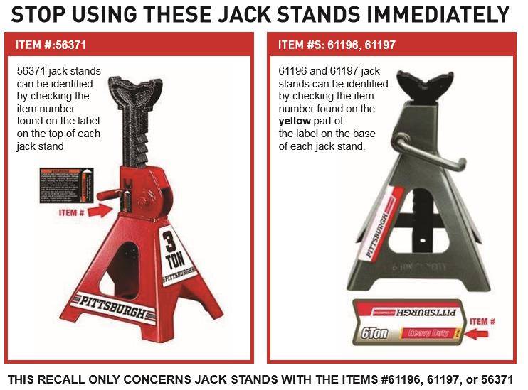

Harbor Freight jack stands recalled
Pretty sure mine are all older than that anyway, but definitely good info to have.
I'd venture to say we risk our lives with all of them.

I just exchanged mine yesterday. Absent an earthquake, who places their jackstands in a position where they would shift the load once placed? I'm not sure I've ever had that happen in 4 decades.
I always give my cars & trucks a good nudge before getting under it just to be sure, and most times leave the floor jack under the car just in case.
What company in the US makes this style of jack stand in 2020?
This same jack stand design has been on the market for decades by a lot of different manufacturers. I wonder if the tolerances of the lock mechanism in the Harbor Freight versions are sloppy or something? If not - then it is a risk with the overall design which could be an issue with all of them out there.

When I saw how little engagement the pawl went into the teeth on jackstand, I quit using them and bought some good stands made in USA. Somewhat pricey but it's me under the car and I'm worth it.

Gotta go to the shop now and pick up my jack stands to return, I have six of them, four are under a car! Guess Ill replace them two at a time.
I just took my two 3 tons back & they gave me a gift cart for them. Didn’t buy any more since I have a bunch of others already.
Have to wait till I get my car off the 6 ton ones to return them. Have a secondary support there already anyway.
Have used those for years without issue, but better to be safe.
