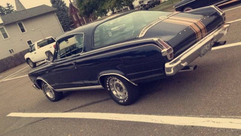

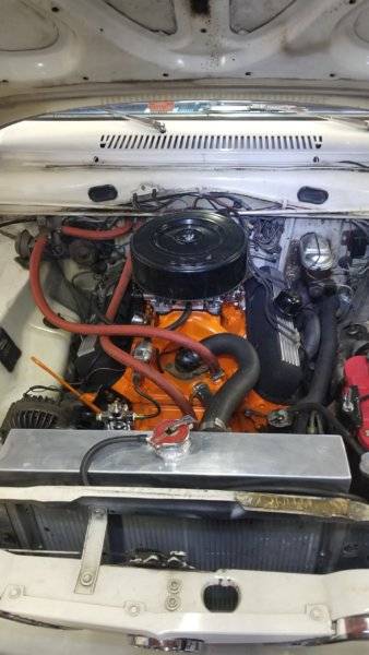

1965 Barracuda 273, .030 over, Modified Edlebrock performer 318/ 360 intake.
