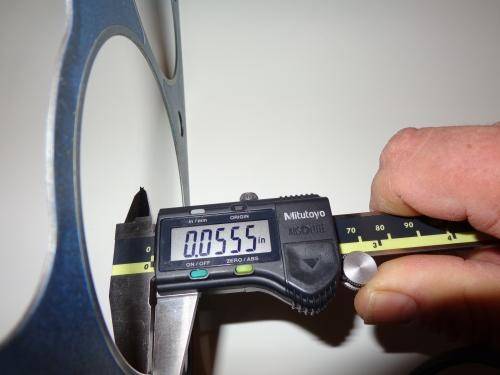

Today is the first since I read this thread iv had a change to get to my shop. I measured my 8553pt gasket im getting .056 new that's uncompressed.

Expect to measure different....but consider it will compress about .004

If you can trust the .004 crush after reading the variation of .010 thickness ootb.
I still don't trust it, is all I'm saying.
What I read says up to .009 after compression. Either way .05 gets me in the ballpark enough to get a fairly accurate scr number. +or- .004 isn't that big of a change. I know my particular gasket is .056 so i will just use that number - .005 for compression and roll with it haha
