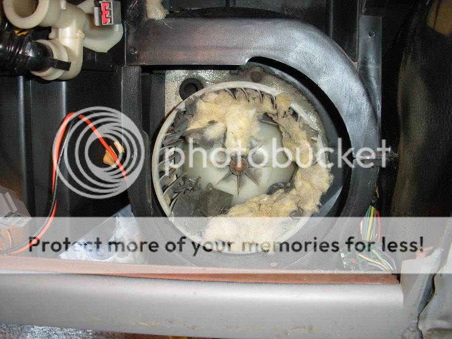

I have found heater boxes so packed full of leaves, and dirt, that it partially blocks the airflow. If everything checks out that everybody is,telling you to check, id recomnend taking the heater box apart, to clean it out. Bet theres 40 plus years worth of dirt and leaves in there.
I also seen insulation packed around the heater core where the blower couldn't throw the heat. Thanks to the mice living in there.
Also, does the heater motor / blower seem to be running up to speed on high? Could be an electrical / bad motor issue, as well as various types of "plugged up" and internal doors issue.
