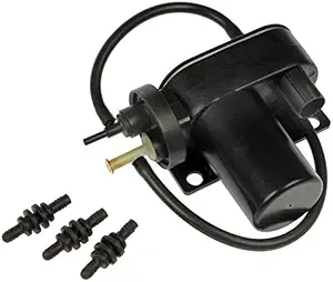

          How about a vacuum can or a Hydroboost setup off an astro van? Do you have power steering? This is a $60 vacuum pump off a Ford truck. hide it under the floor
