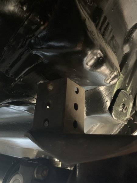

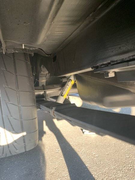

i can’t figure out why the rear is sagging so bad, it does have full tank gas, brand new drag shocks, the adj pinion snubber if I put it in will hit na matter what. Not sure why the rear shackles are also hitting. Here’s a few pics. Trying to get ready for drag week and this popped up, just got the car done and can’t figure out why sitting do damn low. Original rear springs.
When I use a jack to try and lift the rear end up it just keeps going up into the wheel well, really doesn’t lift the car. Is if the springs that went bad? I can’t imagine it’s the shocks.

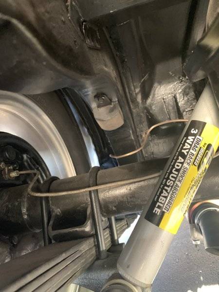

From the looks of the gaps between the leaves, I am wagering that more than one leaf is split in two at the center bolt hole. Pretty well done what they were intended to do and then some...
Yes agree that the lower short leaf is split in 2 at the center bolt. I blew up the photo of the Driver's side leaf, looks like there is a faint up and down crack on that lower leaf between the U Bolts.
Same thing happened to this 67 Dart, both sides that short leaf was split in half. Put the so called Big Block lower short leaf in the stack (3/8" thick). It gave the car a 2" Lift and still rides nice, not too stiff like the new Super Stock Springs can be.

Thanks, figured it was springs. Gonna tear em our today. I suppose it’s better to happen now than 800 miles from home. Oldmanmopar I wish you were closer. Thanks for the offer but I needed em fast. Got a pair on the way.

Back when I used a snubber, I had to cut it down to fit...If I recall correctly, what is shown in the pic, I cut the top 2 holes off. I would trim it to give about an inch or 1.5" of clearance.

I hope that's not copper brake line in your second photo.
Original springs would be pretty much level when fully loaded. So that part is not terrible.
If the other guys see a crack, then that spring set is more than done.
Can't see the shackels, but they should be angled back and have room to move more vertical as the car rises.
So that's another indicator.
If its not cracked, or you going to go with a stock rear spring pack, cut the box sections of the adjustable snubber so its just touching. If the spring is not totally destroyed it will get you by. Even with BFG Radial T/A I found riding the snubber helped the launch and reduced the spring wrap.
It’s the Nicop stuff, nickel/copper mix. It’s legal brake line just has a copper mix.
