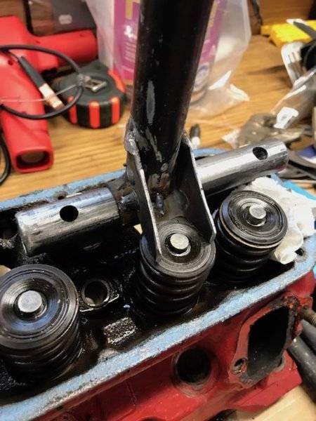

Progress...
(edited)
Removed the springs/valves.
some of the valve spring spacers under the springs were broken, and this explains a couple of pieces found in the oil pan a while back...
I made up a valve spring compressor tool... which worked really well, once I put a socket over the spring and gave it a good strong hit to free things up...
not much carbon build up, and the cylinders all look really good.
more later.....
