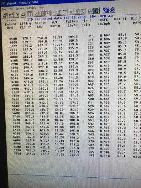

those 987 springs are more then enough for your cam.
As your own testing has proven....... they’re good for about 5600rpm with that cam and those rockers.
Without completely revamping the entire valvetrain, as you’re now planning to do, what were his suggestions for getting the motor to rev beyond that point?
