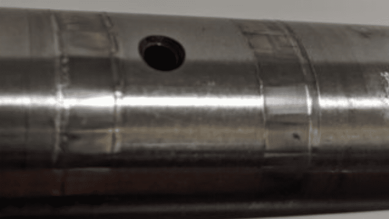

Ok guys a little update. I.took a closer look at where the gouges are on the rocker shafts , and they're being caused by the very thin shims that were used. The areas that are nice and smooth had no shim in that spot... I noticed it when I checked the other side and there was only one cut mark on that shaft.
You have the advantage of having the pieces in your hands........ and ultimately it’s your decision on how to proceed.......but this certainly doesn’t just look like it was caused by the shims.
Maybe the OP is referring to something else? If 'gouges' means the troughs that PRH is showing, those are not caused by shims. My PRW PQ rocker needles damaged the shafts in exactly the same way that you shims. The rockers and shims can't move that far back and forth to make that wide trough. And, yes, not all the needles did that kind of damage at every location in our case, so I can see where one side could be OK and not the other.
BTW, if you wanted to try those rockers as they are on some different shafts, you might have better results. Maybe there is a source of hardened shafts better than the one that came with these rockers.
I'm not talking about the wide wear marks from where the bearings sit. It's where the shims sit there is a small cut mark that you can feel with your finger nail.

Or just put that roller bearing crap back in the motor and see how much money it takes to build a new one when the rockers chew through the shafts and all the other stuff that will break. New rockers and shafts would be a big bargain.

if you have to run needles on shafts
No chrome shafts
shafts must be case deep hardened not electro- induction or flame hardened
check carefully
rocker arm specialists has the real thing for sure
best are case hardened chrome molly shafts

sleaving/ bushing rockers is a good answer

OP, before you do anything rocker wise, you may call Mike at B3 racing engines and see what he thinks about putting bushings in the rockers you already have. Other than the needle bearings, there is nothing wrong with those. Press bronze bushings in them, score some new shafts, correct the geometry and don't look back.
That may be cheaper and better than starting over with new rockers. I'm pretty sure he has the tooling to do that. I used to, but that was all stolen by a common criminal and sold to a bunch of production rebuilders in Mexico (true story) who have no idea what all they bought.

That's a really good idea thanks. My local friend who builds lots of badass Mopars works with bullet cams alot. he's going to be talking to them about building me a custom grind for me.
