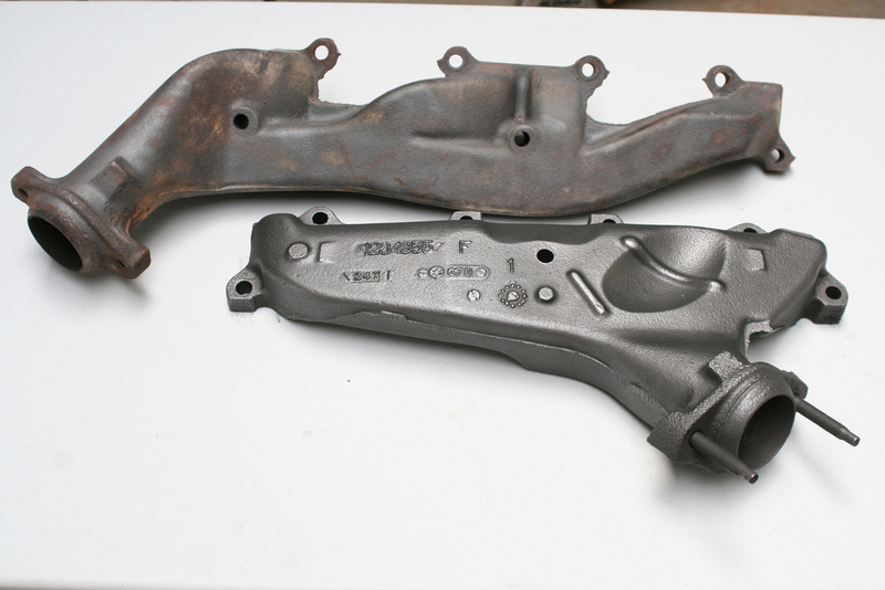

Here is a before picture of one of the exhaust manifolds I did for a customer with a Chevy 83 Stepside. It was in pretty good shape. I HIGHLY recommend getting them sand blasted. Wire brush may get it looking clean, but it has to be clean. The wire brush will leave a lot of contaminants stuck to the surface and in cervices. I think is best to have them blasted. DO NOT have them glass bead blasted if you plan to use the special paint I use. It specifies it on the can. Glass beads leave the surface too smooth. That smooth surface may be OK spray can paints, but a slightly rougher texture will help the paint stick better.

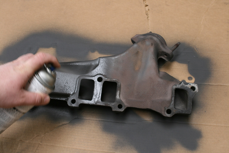

I spray my paint on, but you can brush it on with a foam brush (just be careful to not get on too thick). I always spray on two medium wet coats.
