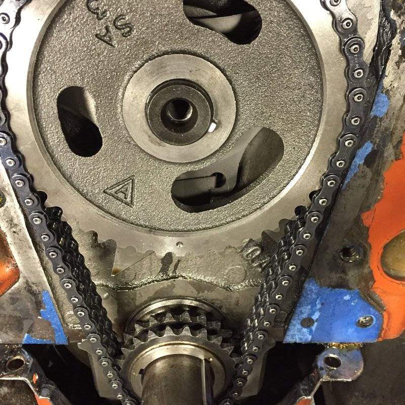

Not sure if it's been brought up already but could the cam be degreed in wrong? (Not sure it would cause any smoke but.....)
The dots on some of the inexpensive chains are hard to see. The first engine I ever had built the shop lined them up and it ran like garbage.
image-jpeg.1715008856
Cam was degreed with a wheel, triple checked since sometimes even two times is not enough to trust myself lol.
