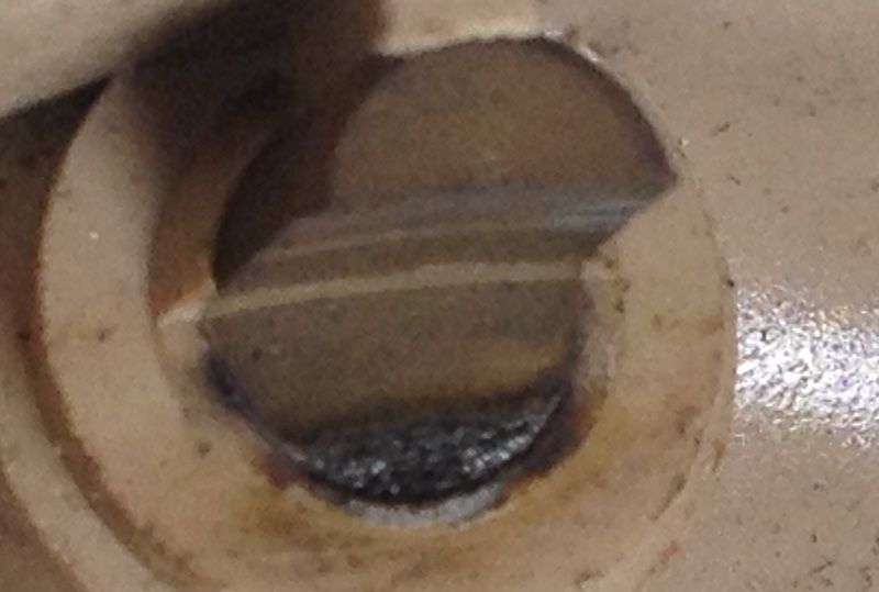

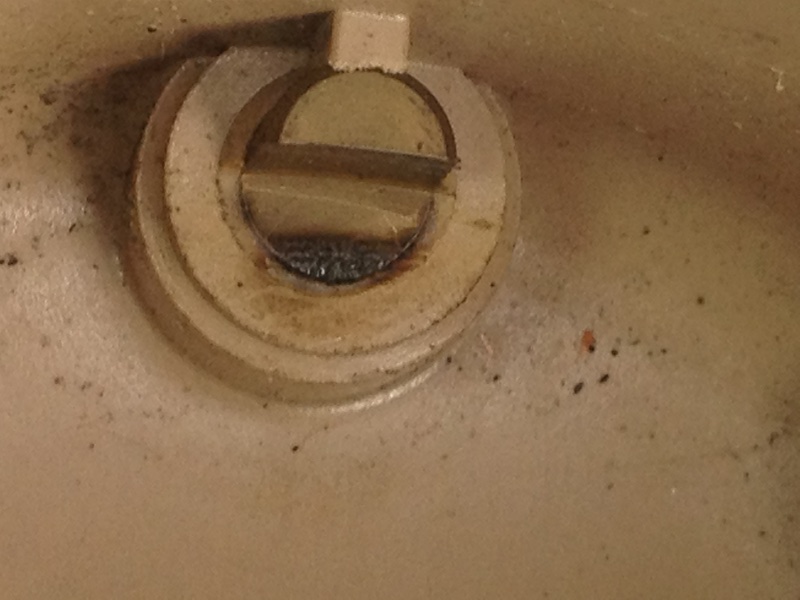

The existing cap already has brass inserts. Make sure the spring leaf on the rotor contacts the carbon button in the cap. It has been making contact because there is some wear of the button, normal wear. You cam measure the resistance of the button. Under 1000 ohms is good; looks to be a performance cap because it is made of Rynite. Result of a new cap will be a lighter wallet...& nothing else.
I was referring to the phasing of the rotor possibly being off from the wear on the brass inserts. Maybe a lighter wallet, but if there's a crack that I can't see, I don't mind ruling it out.

Regarding the phasing on the cap. If you have a vac advance and it is not hooked up, that could account for the arcing on the side of the terminals. The vacuum can when applied will sweep the rotor across the terminals lining up the rotor with the cap. Hope that makes sense.

Ah okay, I had no idea that could be the case regarding the Vacuum advance, and no, it was not hooked up, so that makes sense.

Ok, so I had that happen to me with the cap. I had a small flutter around 4000-5000 rpm. Not big, but annoying. Found the cap with the burn marks on the top of the terminal. Ignition is erratic depending on where it arcs upward. You need to lower the rotor in relation to the cap. I sanded the base of the rotor which allowed it to sit lower on the shaft. Stacked tolerances and old tooling and different manufactures.
