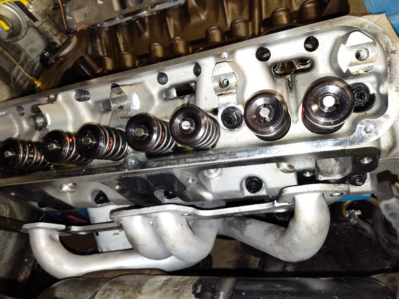

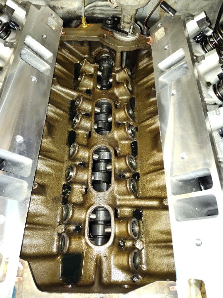

Unbolted the rocker gear completely, and ran another cold leakdown test- all cylinders sat with air for a good 5 mins, TDC verified on each one, and all leaked between 5-7%. Pushrods, rockers, shafts all look good (a bit of wear on the pushrod coating with the light contact in the pushrod holes, but nothing bent). Next, I unbolted the intake- of gaskets were perfect, no evidence of water or oil getting past the crossover or through the bottom of the ports. Gaskets are so good they could probably be reused! Cam lobes all look good- all lifters spin as freely in their bores as they did upon initial assembly, and although some wear patterns are further to the side than I'd prefer, overall no concerns with the valvetrain or cam. Next I drained the engine oil into a clean clear windshield washer fluid jug. The engine has a stock pan and had 5 quarts of Lucas SAE30 break in oil- it filled the jug, and then quite a bit more in a regular drain pan. Oil is black and reeks like gasoline, although I'm not sure if it's just me or I actually drained more than I put in this thing. Next, I unbolted the exhaust on the even cylinder bank since that was the one that was really smoking badly from oil (or carbon and gas mixed?)- all the exhaust ports on that bank except for cylinder 2 have the same sludge in the port as what's coming out the tailpipe.
I'm at a bit of a crossroads, as I was truly hoping at this point I would have found more damning or obvious evidence of something wrong. Obviously I have not removed a cylinder head to check the head gaskets, nor have I tested the oil, but judging by its smell, it seems it's contaminated with gas possibly, not water. Not to mention my previous leakdown tests had no bubbling in the water of the rad. A couple of friends with more knowledge and experience than I suggest I put it back together and we wire up an external HEI module to run it and rule out a bad ignition box (even though it's a new but older Mallory hyfire that I've triple checked the wiring and settings on).
At this point, I'm a bit confused of what to do next. What I'm seeing doesn't seem like a typical head gasket issue to my knowledge, and the multiple leakdowns and compression tests at this point suggest to me a healthy bottom end and valves/seals...I've cleaned up the intake for reassembly, but am wracking my brain about anything else I could be missing here before I spend more time going backwards possibly. I've attached some photos just to show some of what I'm talking about here.

One thing I noted from your photos... looks like the block still has the dowel pin on the china wall for the OE intake end gaskets to locate. If that block was decked at some point it's possible the dowel holds the intake too high giving you sealing issues. Most people remove the dowel and make their own end gaskets with a thick 'ol bead of TheRightStuff. Probably not related to your problems but something to consider looking at during your re-assembly...
My guess, either fuel pump ruptured the diaphram and filled the crankcase with fuel. Not sure how long it has been run, but that scenario kills bearings. Or the carb might be dumping raw fuel out of a booster and washed the rings. Making the marginal ring seal situation very problematic. Are all the valve tip heights equal?
