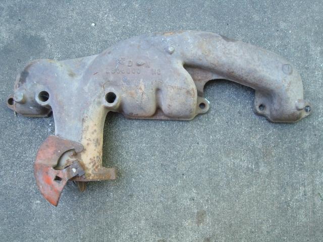

I have a nice passenger/right side hipo manifold, correct for 67-69 440 Magnum. I can post a pic if you like or shoot me PM for more info. :glasses7:
Here is the one I have, heat riser stuck and it looks like the counter weight is missing, but many people remove this stuff anyway. Doesn't appear to have cracks, no repairs, no heavy rust pitting and will clean up nice. $150 shipped

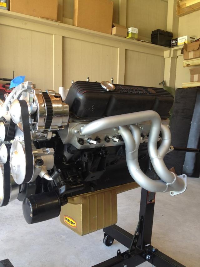

Sounds good to me. I currently have a set of Shumackers on it. Any idea which will give me more clearance? I'll post pics in a sec.
Here are the pics

Waaaaay lower! Not sure what the kid I bought this from was thinking. I have Tony sending me a 933 pan. Thanks!
I just want to make sure that the exhaust clears the power steering and what ever else is on the drivers side that might cause issues. :)
It doesn't sound like you need/want to get everything out of this motor on the street but if you go with exhaust manifolds and have some $ burning a hole in your pocket, you can always have them extrude honed.
Those headers don't look like they're gonna be much more effective than the HP manifolds. They're ANTHING but tuned! I'd sell 'em to somebody with a Street Rod.
My main concern is clearance. These Shumackers are the same design as the TTI's and 2 1/2" is as big as I can locate that may work. I guess I'll go ahead and get the manifolds just in case I have any issues. I appreciate every ones input!
