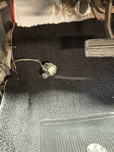

Can someone post a picture of the placement of the headlight high beam switch that's next to the kick. Trying to get it in the factory position after floor replacement. I could only find a post about b-body and in that instance. It is locTed right below the pinch weld. However that seems low to me. Here is what i got.. thanks.

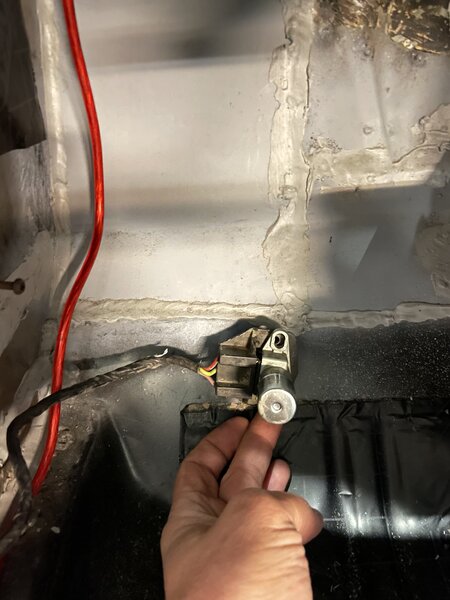

Word!!! That is perfecto..right above the pinch.. thank u broski!

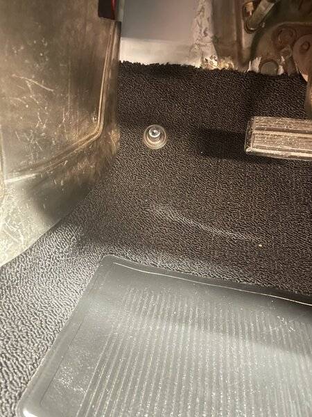

screws on the diagonal to put the plug in just the orientation as in the picture (wires should go immediately under the edge of the kick panel), and much closer to the kick than a B-body
