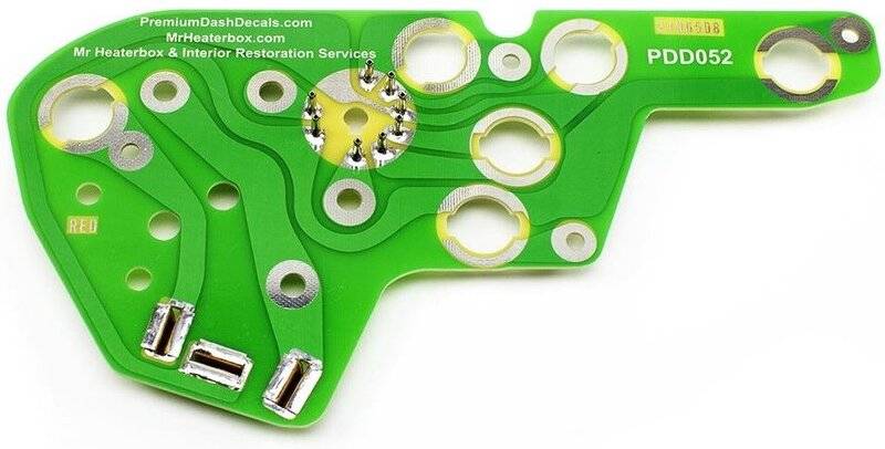

Then I tested the mini-bulbs and they are all new and filaments intact and separately they work. However, when installed on the circuit board It seems only one dash light will work. Cleaning did not help. Looks like the metal tracing conductor has worn off after 50 years or so.
I ordered another circuit board from a Canadian source that ships internationally. It looks to be even a higher quality than the factory issued piece. End of story for now. Thank you all.
P.S. The only thing I see with the new board is a possible discrepancy with the hole in the center of the pin module. The factory hole is round but with an extra dogleg in the bottom that matches the pin plug of the wiring harness. Not sure at this point, but that dogleg may have to be "carved out" some before final installation.
