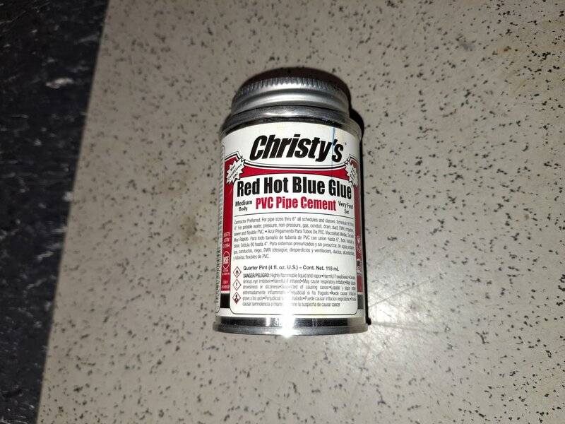

You are on the right track.
Get the corrugated PVC started with a a small screwdriver. After you have it started peeling grab the end that is now loose with pliers. Some times needle nose works best on small diameter fittings. Pry with screwdriver and pull peal with pliers.
Sand with 220. Clean, Prime and Glue with the Hot Blue Pool adhesive. Let stand one day before use.
Fill tub and call the Bikini Chicks and make Frozen Drinks.
or it leaks.
Here's to hoping it dont end up that you, fill hot tub only to find out the jet body to tub seal is hard and leaks and it was all for nothing.
Then it is chip-grind the insulation, cut the nut off and new jet and jet body with fresh seal of course.
Please post pictures of the hottest in the tub.

sounds easy enough, thanks for the help
the tricky part will be the bikini chicks, this is a 2 person hot tub that me and the wife use for our "morning meetings" and dress code is birthday suits
That's known as hurry up and wait.....
No kidding, I told the wife at least 72 hours
I'm gonna let this dry for 24 hours
Then I'll put enough water in it to see if the new PVC is water tight (get the level just above the jets)
Let that sit for 24 hour and make sure it's none dry, then I'll clean it up and refill her, should take about another day at that point to get up to temp again
So far, I'm optimistic, it went together pretty well
It was real tight untill I got the primer on, then it just slid in
