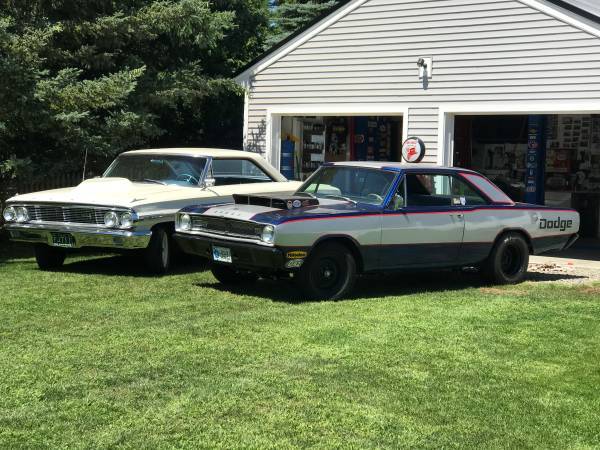

Thanks for your info its my first 904 I have a big block duster with a 727 and its been bullet proof. Just bought the Dart it has so many high end parts its crazy just wish it had a small block 727 I have paper work on everything but the tranny build im hoping the builders didn't skimp on the tranny the car is done realey well. Worst case is someday I'll install a built 727.
