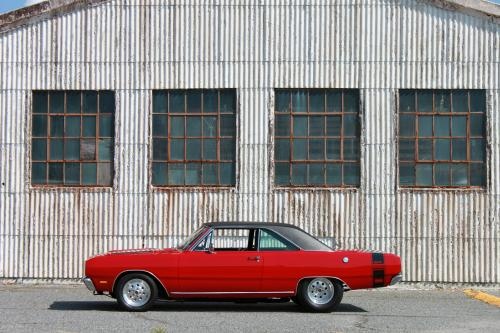

How to get to this 'stance'
My concern would be what happens when you get people in that car when it is already sitting that low?
I always loved member "BrianT"s car/stance...Plus it has a Dana. :D
BrianT's Dart sits like a muscle car....nice job!
i would take a spin in BrianT's car or Youngguns
both are nice if you ask me. i would have a hard time choosing, would have to pop the hood first lol.
Thanks for the kind words everyone. It was just dumb luck that got the stance right on my car. I ordered +1 springs from ESPO and they settled to where they are now. Careful measurements got the narrowed rear end and wheels centered where we wanted them. We put everything back together and then looked at each other and said Right on!
Moparlover...if you popped the hood on mine right now all you would see is an empty engine compartment needing to be finished. They're calling for nicer temps this weekend and I plan on getting back after it then.
Here's another pic to get us all motivated. The driveway slopes away from the house so the *** end looks a little higher than it really is.
