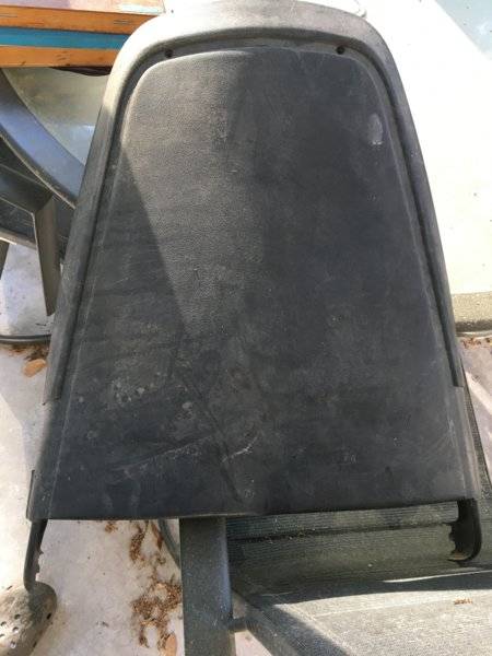

I will post pictures. I got lucky and all the pieces came with the seats. From a person on this site that found them in his 68 barracuda
Cleaned up one with just water. Been sitting in the garage since I got them but seats are being recovered so I had to get things in gear
