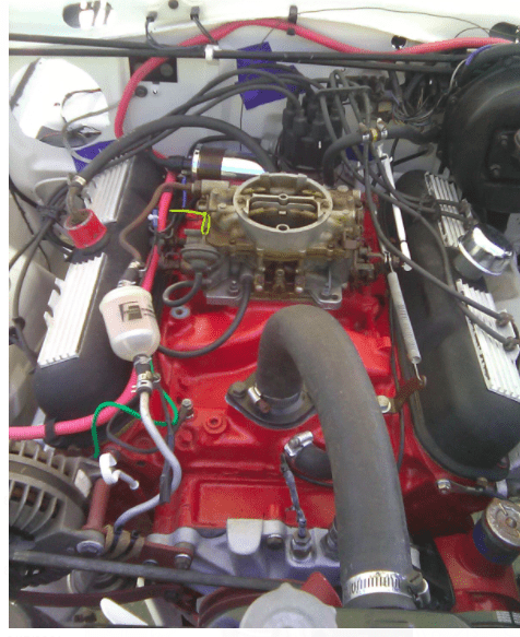

Mine is fairly close to the question asked, but the 318 doesn't have a dual-point distributor, high compression pistons, or a solid camshaft (but it does have double roller chain).
I have a circa 1979-1980 318 in my 1965 Formula S which uses the factory chrome air cleaner, factory Carter AFB 3854S carburetor, factory finned valve covers, a factory intake manifold (1966 273 manifold to match the 318 intake bolt size/angle), factory Torquelflite and a 2 1/2" TTI exhaust with stock 273 exhaust manifolds. The 318 received a stock rebuild so uses the stock 318 long block and hydraulic camshaft.
From a stop, the transplanted "open" 489 case 8 3/4" rear-end will spin a tire or two if I step on the accelerator a little too hard. I believe the ring and pinion ratio is 2.76.
I don't plan on any changes, and I did not plan the "build" this way, just used what was on hand (mostly from previous owners).

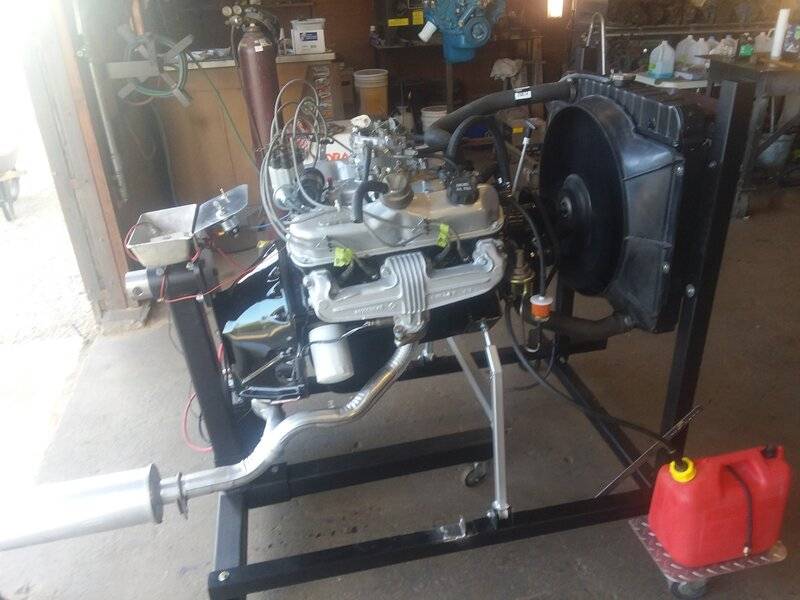

superstock64polara, I am with dibbons. The 318 was a 48K take out from a 70 Coronet (free)that was getting a Big Block.
Bottom end is stone stock. Edelbrock 600 along with the performer intake with the 318 size ports.
I went with a Comp Cams 268H-10 cam and matching valve springs.Mancini timing chain tensioner.Heads were cleaned up and gone thru.Cheapie Jegs headers.
Little things really wake up a Teen.

I think it runs great,for what it is.Low budget in a beater that most would use only as a parts car.
A B&M shift kit in the 904 and a set of 4.10's make for some real fun.And JUST for fun.It's what you do with left over parts.
I built the car in 2019 for the Tucson zip tie drags. Health sidelined me 2019,then covid 2020, then a new granddaughter, 2021
Maybe 2022 if they have it again.
