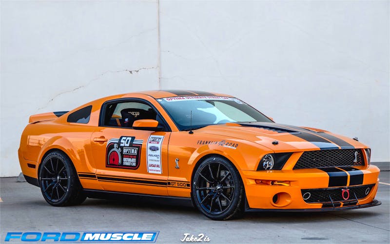

I think this Mustang does a pretty good job of representing this idea.
This is an earlier build of this car, it has had more work since then. And I can't tell if or what was done for things like windows and such. But it has certainly had the dash stripped so I would guess it doesn't have much of the original electronics left. Although, it is an '08 and a Ford so not really sure how integrated they are.
