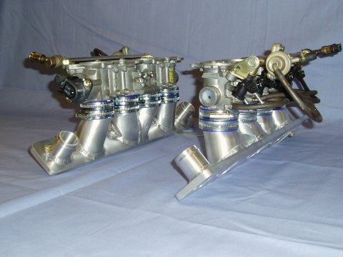

Lately I've been investigating "ITBs" off of various stuff like off some of the big bikes, some of them are 46mm, and found out the Chrysler LHS TBs are fairly cheap to be had
This guy made a setup for an LS1

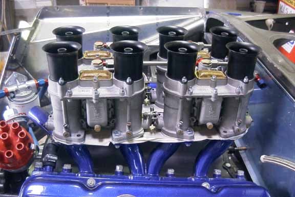

Might have a look at Weber Carb intake to EFI conversions & conversion parts. Something like this from Borla (TWM) Induction:
Still not cheap, but much more common parts.
Two options that I know of:
http://www.borlainduction.com/
http://www.inglese.com/
Unless that's not the look that you're after......
