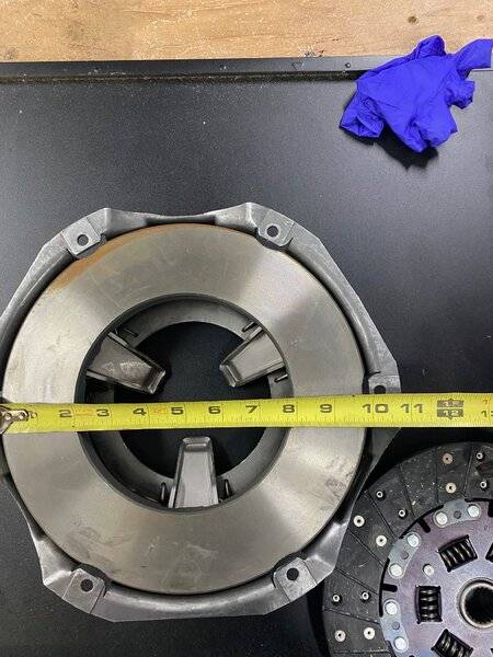

Hi, I'm in need, I mean I NEED, a 9 1/4 DIAPHRAM pressure plate so I can make some progress. I have a 9 1/4 friction disc as pictured but the pressure plate itself is useless for my needs. It's for my '63 dodge dart with an A833. 122 tooth flywheel
so help! ;)
dne'
my build
That's what I got. The 10" disc with the scalloped pressure plate. Brewer used to have that kit but the clutches they have now are way better. @Dan Brewer can fill us in in the new clutches.
That's what I have for my 4 speed.....a slant 6 van clutch. You just need to use some Allen head bolts instead of the stock hex bolts to get some extra clearance so the disc doesn't hit them.
