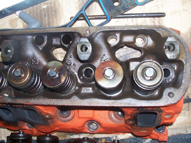

I drop a pushrod in and set the roller rocker set on and things just don't line up. After a few hours of measuring with the calipers. I have determined that the 92 roller cam heads have a 5/8 Diameter hole for the pushrod and the 71 heads I bought have a 7/16 hole. So sounds easy enought lets just drill out these holes a bit bigger. Nope it seems the hole is offset 1/4" and I just don't think I have the room to cut out that much.

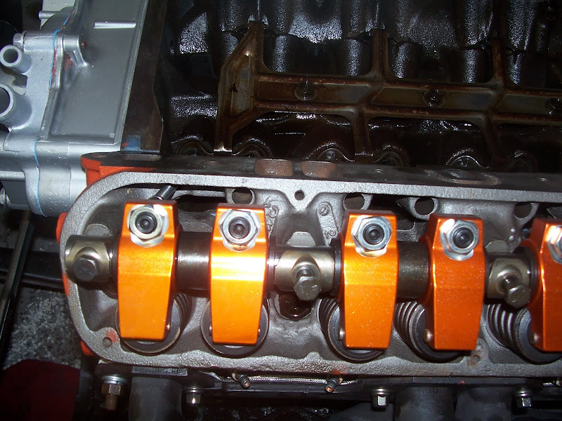

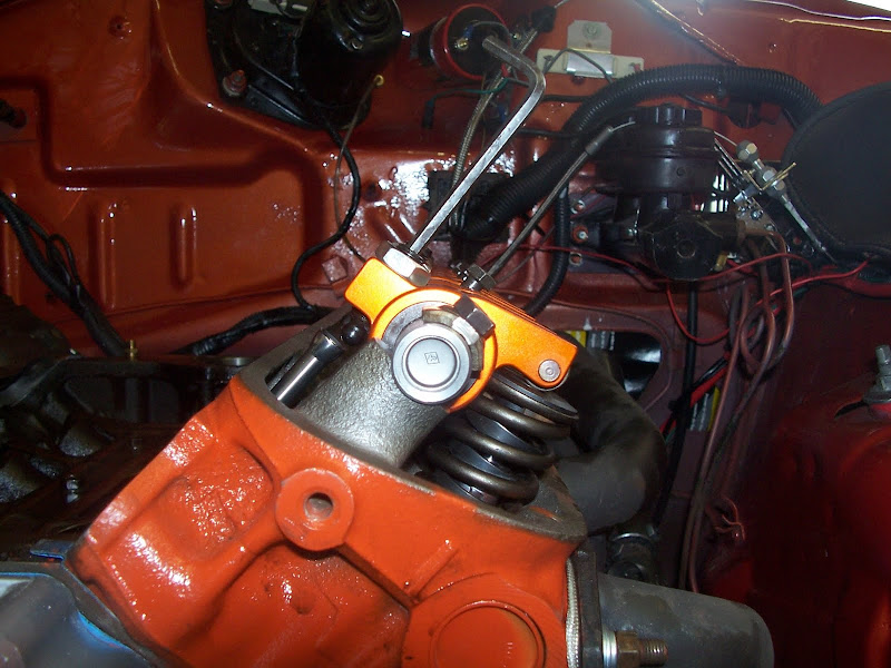

This is a 92 Roller cam la block. Not a magnum. Pushrods are 6.35 in length. Harland and sharp 1.5 ration roller rockers. The problem is that with the roller cam the lifters are much longer than that of a non roller cam. So by making the pushrods shorter it takes more angle for the pushrods to move up and down.

AAAAAAAAH. Ok now I'm a little clearer on the situation. It still looks like the pushrods are a little short
Yes they are but that is a separate issue! lol. If they where the right length they would not line up. I was showing that picture to show how much the offset difference between the heads are.
just a wild thought im not an engine builder. im wondering what the offset is on 340 ta heads if their rockers would straighten up your geometry. are you sure your left and right rockers are positioned right?

Yeah the stock heads that came off the 92 had 5/8" holes for the pushrods. The rockers are in the same place as stock. I threw the stock set of rockers off the 92 onto the 71 head and had the same issue. The issue with drilling it out to 5/8" is the 92 5/8" hole is offset about 1/8 inch toward the rocker. I don't think I have enough metal to move the hole around that much.

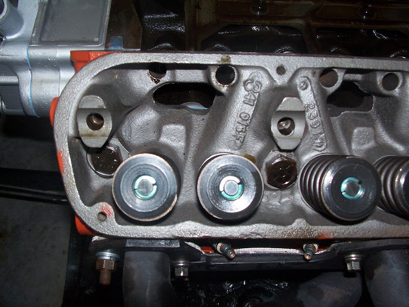

Stock 92 Roller cam head with 5/8 Push rod holes. Look at the distance from the edge of the head. Then look at the other picture. Not only is it smaller on the 71 but its closer to the edge.
71 J Head. 7/16 push rod hole. Hole is right against edge of head.
Take them off and drill them. There is enough meat there. Even doing it by hand. But I would also disassemble the heads for cleaning after. Also, longer valves, but no lash caps? The rocker tip doesnt look right to me. Make sure everything clears and the sweep is good. It looks to me like they might hit the retainers without caps.
There should be about 3/16 of material there and you only need about a 1/8.
Not to mention the direction the pushrod needs to move is AWAY from the cover gasket surface.
The hole needs to be elongated towards the rocker shaft.
You need rocker shaft spacers to correct the geometry with the longer valves. The longer valves raises the roller tip and pushes it too far to the outside of the valve and it also drops the pushrod end of the rocker and rotates it in, toward the rocker shaft and away from the stock pushrod location.
Shim it up the shaft to give yourself the correct roller tip/valve stem contact and the other side will should be in a more stock location. Then measure for new pushrods. With a bit hand drilling on the pushrod holes, you should be right on target. :)
