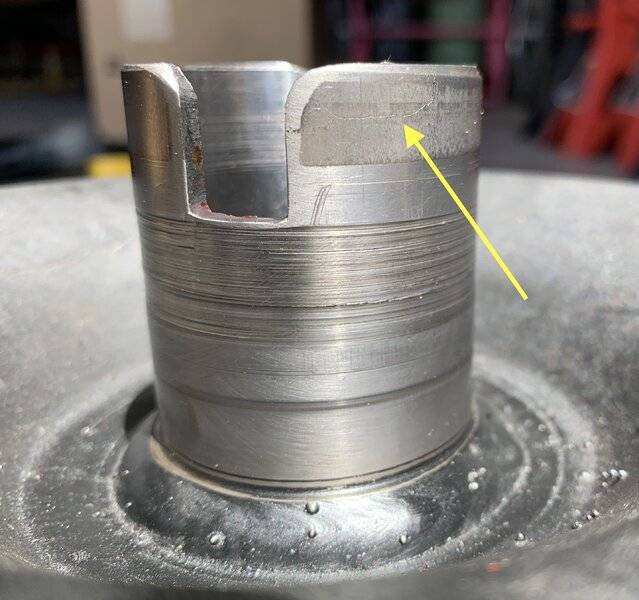

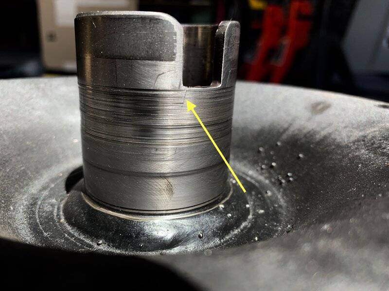

Okay, had some time to pull the converter. Originally I said it was the snout that was scored, but I misspoke and meant to say it was the hub. Anyway, here are some pics.
You can see there is obvious scoring along the body of the hub, easy to feel with a fingernail. But there's also two cracks I found, indicated by the arrows.
The bushing looked brand new, which I found strange. But I forgot to take pics before putting everything back together.
Yes, with a new converter. The transmission is still out of the car, I'm guessing it's pretty important that I replace that bushing?
That hub was scored from low fluid level. I see it all the time. But it's just silly to replace perfectly good pump bushings; which I see 90% of the time; and NO, I do not replace good bushings with new ones; makes no sense. That converter is so worn that it would run off center; hence the leak.
Well, let's see how she runs now. I'm waiting for a lower ball joint so I can put the front end back together, then everything goes back in the car.
Yes, I've seen many times that the converter is all wore down but the bushing is, somehow, undamaged. But I put the pump down over the converter and check the fit before I put the pump back together; might want to run a chevy bushing.
