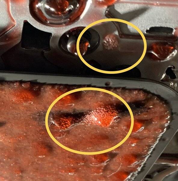

I’ve got the pan off and noticed these bubbly areas of fluid. I never noticed this on the 904 or on this transmission the last time I pulled the pan. Is this normal?
strawberry jam?, lol
NO! Not normal!
I've never seen that either.
All same brand and type of ATF installed?
Looks like aeration alrightee, but these many days later, it should be all back to normal. ATF has additives in it specifically designed to break these bubbles up, in minutes or less so...... IDK. I'll be watching to see what I can learn.

I mean, the consistency is no different from good fluid, I just noticed these bubbly masses once the pan was off. I kind of thought it could’ve been from the possible aeration you theorized.
