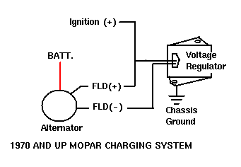

I need to know how to wire this square-back 3 wire alternator. Can someone tell me where the wires go when you have no factory wires.

As shown in the diagram, the one terminal on the VR goes to switched 12V "ignition run". It branches off to EITHER field terminal. The second field terminal hooks to the remaining terminal of the VR. VR MUST be grounded to battery neg. MUST. A good way is to install a ground cable IE "Ford style" starter/ eyelet to eyelet cable from rear bolt hole on driver side head to firewall, sometimes master cylinder studs work good for that. Remaining wire is output, at big stud on alternator, goes to battery. I'd run at least no 10 for stock alternator, either a pair or 3x not 10's in parallel or no8 or larger

How do I know which field is +\-?
On the + that goes from alternator, T’s into the ignition and goes to regulator. Is that on only when key is on/run position?
What size wire should these be?

So the fields are interchangeable?
Yes, and that reminds me BE DARN CERTAIN that you CHECK the field terminals for continuity. The two field terminals connected to the rotor which is a simple electromagnet. They should show a low resistance or "good continuity" from terminal to terminal and infinity/ open to ground. This is a common problem on rebuilt/ etc alternators of this type

Simply make a wire to fit one of the fields and bolt it to anything metallic. I used to bolt it to the inner fender to make sure it was a good ground and had a short wire, but you could bolt it to where the ground strap is on the firewall or anywhere else you can find a good ground. Had to do that when I used a 69 dual field alternator on a 68 Dart...
Ground one of the fields then you won't have to run a newer VR...
I would rather see him run the 70 and later VR. They are much easier to come by and a better design.
But if you do modify it, just ground the terminal to the alternator case. BUT BEFORE YOU DO please do as I asked to make sure one is not already grounded, AKA check continuity from each terminal to the case. Both should be OPEN to the case.

If one of the field terminals is grounded, and you ground the OTHER one, you will burn up a 69 VR. If one of the two is grounded, and you use a 70/ later VR, and if the wrong field is connected, you will burn up the switched ignition "run" circuit. What I am saying is, it is COMMON to find an isolated field alternator--such as you bought--with one terminal grounded.
I had issues with the alternators not lasting long if just grounded to the case of the alternator, grounding it elsewhere worked much better. But you are correct, I just don't like doing it that way...
i will run it to firewall, because that is also grounded to motor/frame. What size wire would you recommend? Thanks for all your help…

Sorry that was for Hemi! My fat thumb! Lol. I have a multimeter and can test it. Now I understand, thank you!!
Another question Hemi, the field I don’t ground, do I leave It open?
