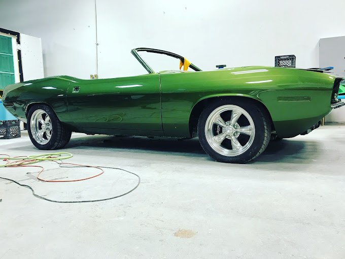

Great match to a 68 F8 Plymouth I have seen in person. The crazy thought of the extreme durability that would result if a whole car could be powder coated just came to mind.

Wasn't the original color a finer metal flake? That looks kinda chunky. Then again my color chip sheet is probably 40 years old. Don't get me wrong ,I prefer the chunky look.

I was gonna say- looks a bit too metal flaky.
I do agree on flake deviation relative to factory original, though one of the neat things about that color is the broad look it takes on from different angles/lighting level and spectrums.

My friend owns QC coatings. He's done several whole vehicles, with zero paint. He did 2 square-body GM pickups, last year, and has done many full tube chassis' for drag cars. He also does the best ceramic exhaust coatings I've seen. Great guys, great work, and if it isn't correct...it doesn't leave. He stands behind all their work.
Home | QCCOATINGS.com
I found his website. Beautiful work. I have coated some exhaust manifolds with a special paint from Techline. The manifolds come out looking great and look good for a long time. But I won't touch headers.
