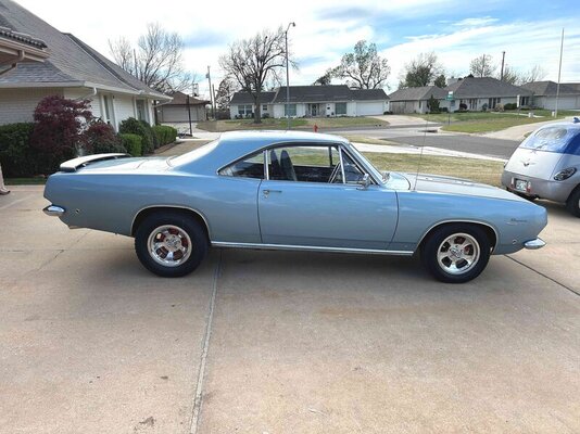

Can someone identify my wheels from this picture?
No markings.
These are currently on my 67 Plymouth Barracuda; but I am unhappy with them.
I'm sure the previous owner thought the bigger wheels/tires, and raked stance were "cool".
But they present a dislike problem for me.
#1 - the offset is bad and the tires protrude from the wheel wells....they are probably at least neutral, with no offset......Therefore, both front and rears occassionally scrub the fenders on rough highways.
#2 - Besides having the wheels more inside the wheel wells, the rear coil over shocks have the *** end set too high for my taste.
I'd like a little more OEM look...just too much rake!
So, I'll probably end up with new rear shocks, and 14 inch wheels with a 4 1/2 inch offset to accomplish what I want.
THOUGHTS??? RECOMMENDATIONS??

The name Rader comes to mind
Just so you know,
it is possible to put 295/50-15s inside those Barracuda tubs, and lower the car to nearly whatever you want. Here's what I did;
1) I moved the springs inboard with the bolt-in kit;
2) I cut off the perches, set new ones on the springs
3) I had the rear narrowed to fit my favorite 10" kidney-slot alloy wheels that had a 4.5" backspace. There was exactly enough room to do all that and I don't think hardly a mm extra, lol.
4) I dropped the narrowed axle down on new perches, centered it between the inner tubs, set the spring spacing, set the pinion angle, and welded her in.
5) Nothing rubs no matter what.
6) with a little hammer work, I got 325/50-15s to fit in there, also on 10s. but I gotta slow down on the turns a lil.
I do NOT know for sure, but......
They look like Rocket, but I'm pretty sure Rocket doesn't make any 5 on 4 wheels.
I suspect they might be Team III/E-T mags, tho I think they would have markings.
Have you pulled the wheels off, and looked at the inside for a logo?
(That looks like the typical mag from the 70s-90s. Not enough backspace)
Finding ANY wheels other than stockers that have enough backspace, and 5 on 4, is getting harder every day.
No markings.
Those are Halibrand clones. I have a set too. They were sold by a vendor at the Mopar Nats a half dozen years ago. No name I ever saw.
Yup! Looks the same.
And the previous owner lived not that far from PA.
Do the center caps have a logo.
On mine, when cleaned up, the inside of the wheel is almost a creamy white.
And, it looks like Halibrand is now owned by Holley.

OP - I agree with your assessment. What size tires are on the car now?
so, my duster's 7.25" is 57.125" wide, drum to drum, assuming your rear is about the same. IF you like the wheels, but want to tuck them in, here are a couple potential lower cost options that might be cheaper than new rims:
if you get an explorer 8.8 rear and do the trick where you shorten the drivers side and use 2 pass side axles, that makes a rear that is ~56.625" wide, effectively adding 1/4" of backspace per side, it doesn't look like that will be enough....
But.....
do the same to a '93-up ranger 8.8, and you'll end up with an axle 55.5" wide, which would effectively add ~13/16" backspace per side....
these axles in yards are cheap (about $200, probably another $45 for a donor pass side axle shaft), rangers '97-10 are predominantly 3.55 or 3.73 ratio, some can be found with limited slip, and most of the ranger 8.8's are 10x2.5" rear drums, so it shouldn't upset your brake bias/balance. non FX4 rangers are 28 spline axles, 2002 up FX4 and explorers are 31 spline.
IIRC the axle centerline to u-joint centerline are very close in length to an 8.25 and 8.75 axle, so you probably wouldn't need to shorten your driveshaft....
If you stay with aftermarket wheels, the Torq Thrust type rims look great and you can get them in 14 or 15 with proper backspacing View attachment 1716250419
They are Halibrand look alikes from China. My caps don't have any center emblems or stickers.
