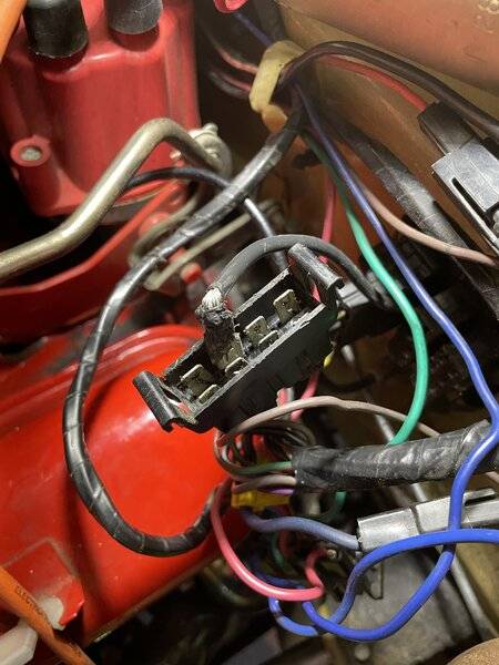

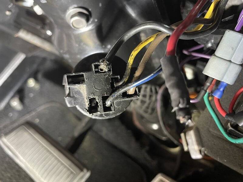

Hello forum dwellers, I just picked up a 68 dart GTS 340 numbers matching. Every time the car starts the Amp meter pegs then as soon as I turn on anything electrical, it goes down to the overcharge line on the meter. I’ve done voltage checks. Replaced a bulged battery and installed a new voltage regulator. someone has already done the high voltage bypass through the bulkhead disconnect. I have discovered that four of the wires going into the packard terminals of the ignition switch connector are frayed and burned from overheating due to high resistance.Does anyone have or know where I can get a replacement ignition switch PLUG or CONNECTOR For this car? Even a part number would be helpful. It’s appearing that this is an item only available through scavenging. Thanks in advance for any help.
The frayed wires increases resistance under load so I would plan on either replacing the connectors OR splicing in Proper SOLDERED and heat shrink joints as the big wires have a lot of current passing through them.
In the mean time after the terminals are repaired you could properly insulate the terminals and put them on the switch one at a time till you find a suitable replacement
I just finished soldering all the spade connectors and wrapping them in layers of heat shrink and reattaching them one at a time to the ignition switch. This will work for now. I still have an issue just not as severe so I need to go through the rest of the circuit. My guess is whoever did the high-voltage bypass through the bulkhead connector didn’t make proper connections throughout. Now I have to chase them all down. I just picked up this car and people say for the money I paid it should all work just fine. I laugh and say it’s 57 years old! It’s gonna have problems. Luckily they’re all minor.

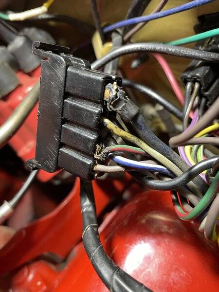

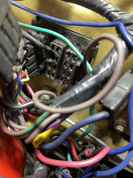

Whoever did the bypass left the ammeter in line. Why? Who knows. Yes there are more things added such as an electric fan and a gear vendors over underdrive. I believe there is a great probability that whoever did the wiring on this thing did it half assed or just plain didn’t know what they were doing. I need to go through the entire system and make sure all connections are good and clean, all grounds are there, etc. and yes, I disconnect the battery before I mess with any of this unless I’m checking voltages. I worked on three phase equipment for microwave communications in the Marines, and overhead cranes and machine tools used in manufacturing facilities. Up to 440 VAC at 600 amp service. I don’t like getting zapped! I was also able to locate a connector attached to a complete used 1969 barracuda wiring harness. A friend of mine had it as a spare, gave it to me for $40. They use the same connector but a different switch package.
Don’t know. After seeing the condition of the wire terminals at the ignition switch I decided to go through the entire system starting with battery and engine grounds. Surprise! Battery negative to bolt on head. Nothing else for engine ground - head/block to frame or head/block to firewall. Added firewall strap, need to do block to frame. I already pulled out my electrical manual with the bypass instructions and drawings to make sure it is done correctly. (Any wagers it isn’t?) Since I’ve only done it once (successfully) I’ll have reference handy. Why don’t I trust other people’s electrical work?

Power is supposed to be supplied from the alternator straight to the main splice with just one connection at the bulkhead.
The fusible link protects the main wires downstream from a big battery short.
The ammeter shows if the battery is charging or discharging.

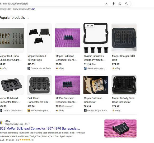

Dana67Dart that’s really nice! Thanks for the push in the right direction for bulkhead plugs. Ordering those from Dante’s. Car should be running end of next week.
