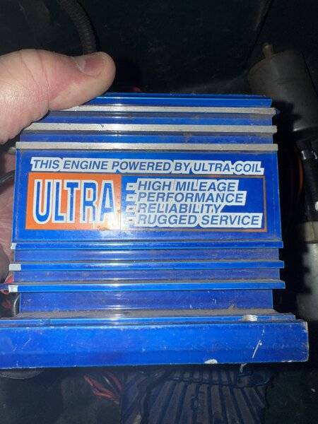

So basically what I was looking to do is I've got these I took off one of my others cars before I sold it, older but I know it works, have a new Jacobs electronic ignition module to make my dizzy electronic and Jacobs flame thrower coil.
At the same time, the setup @TrailBeast shared above looks pretty clean, more modern, possibly more reliable, and definitely more suitable for potential parts replacements... BUT this Jacobs setup worked very well and I already have it so I may just send it!
