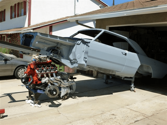

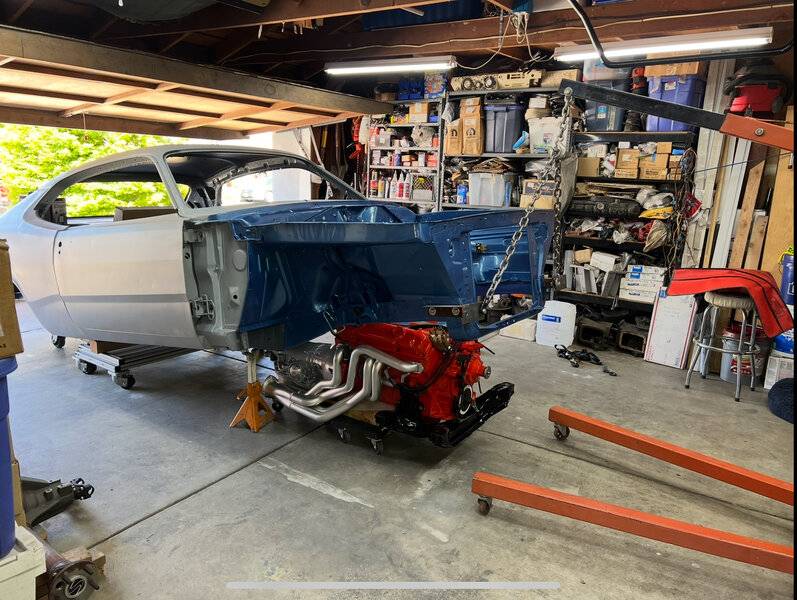

I installed my big block from the bottom with the headers mounted. Was not that difficult.
Second time NS1RM21 did it for his Barracuda, he built a shorter engine/trans cart that's narrower and tapers down at the back/trans.

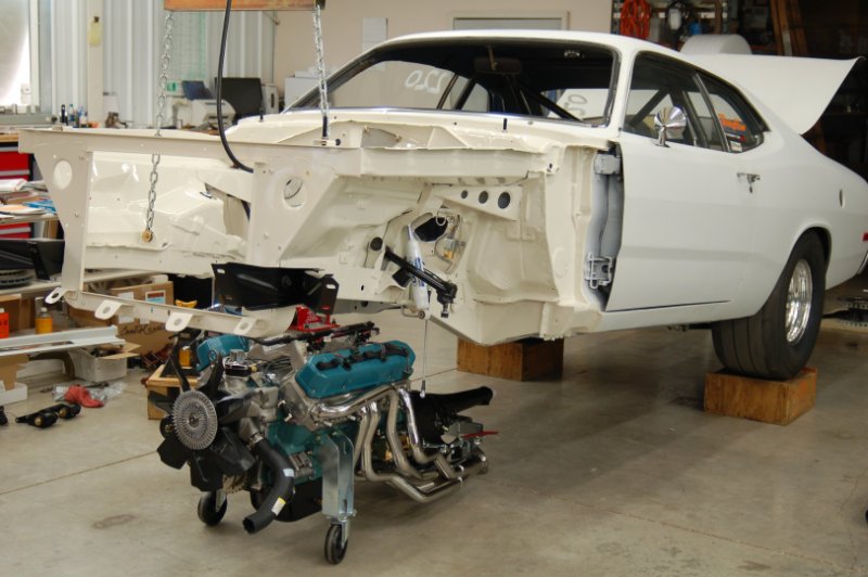

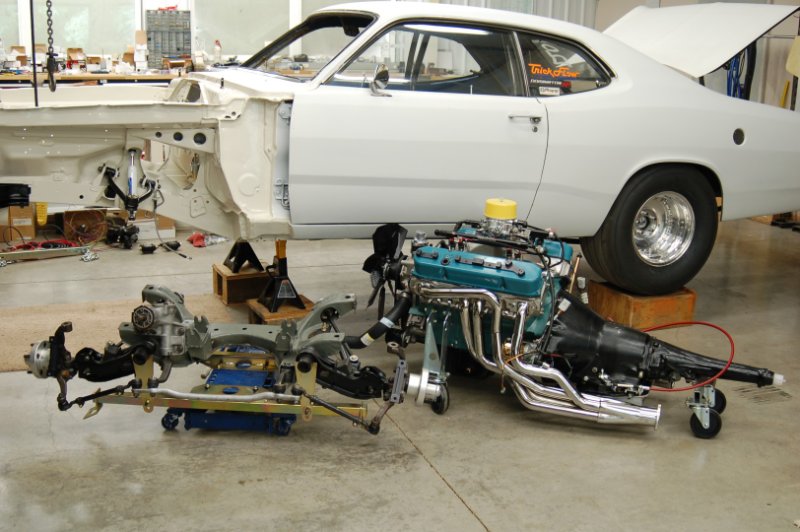

Yep, that is the way to do it. Everything can be bolted on the engine and torqued in place. Then you lift it up into the car and hold it there while you also lift the K frame and related parts into place.
