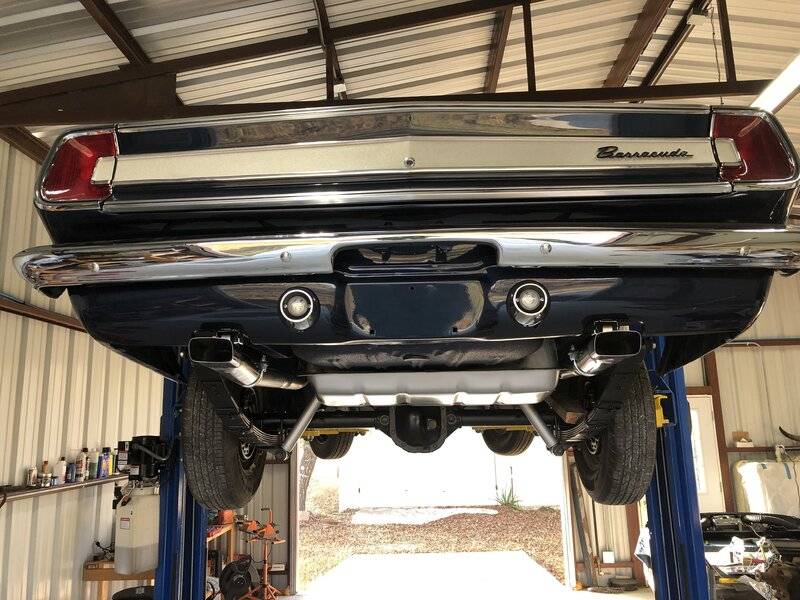

Ok, I spent more frustrating time on the RS leg of the dual exhaust on our ‘67 Barracuda. Got in touch with Accurate (very helpful), but the final solution was not totally what they recommended.
As they recommended, I took the pipes and muffler off, again. I marked the pipes so I would know how far they had “mated.” Accurate said no trimming necessary, just shove them further in. I used a rat-tail file to dress the ends of the pipes to make certain no edges would cause a problem. Still did not fit.
So, I measured I would need to cut about 1 1/16”from the long pipe closest to the muffler to make it fit to the muffler hanger. After that, everything from the header back up the muffler at its hanger could be lined up. Everything had to be lubed to jam the pipes as far in as possible.
Lining up the exhaust pipe and installing the tip was still a challenge. Not according to advice from Accurate, I marked where the gas tank strap and bolt were contacting the pipe, then I “tuned” the pipe in that area with a BFH. It fit after that.
I’m still convinced that I must have done something wrong, but after about 24 hrs on just the RS, my frustrated inner Redneck mechanic took over.
Can’t wait to start on LS tomorrow or Friday.

I finally got it installed. The folks at Accurate had some good advice, but in the end, I had to do some redneck engineering.
On the RS, I had to cut just over an inch off the muffler side of the intermediate pipe. I also had to use a BFH to fine tune the exhaust pipe near the modified gas tank strap.
On the LS, I had to cut about an inch off the end of the exhaust pipe where it goes into the tip.
When I finally get to the point I can start the engine and heat the pipes, if there are no rattles, I will tack the joints together. But right now, it’s installed and it appears to fit - only took about 30 hours.
I am convinced when they built these cars someone threw an oil filter and the the two head pipes on the ground and said, “Now, build a car around that.”
The installed pipes did not clamp tight enough to keep the pipes/muffler from “twisting.” I though I would put a tack weld on each joint, but my welder would not reach. So, I put a self tapping stainless screw in each joint (it goes through both pipes). Twisting problem solved.
