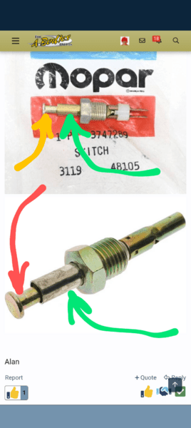

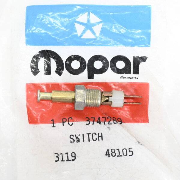

Not referring to the different sizes of switches, there are two different types of switches used.
1. Single bullet connector
2. Two post connector
The single is the normal one, the double is for if you have the lighting package.
The lighting package has its own harness.
So you may have the wrong style switch (not just the size)

Plug the wire on the switch, screw the switch to the car. You can't access the back of the switch to plug in wires after switch is installed.
So the wires are supposed to get twisted?
Figure how many turns the switch needs to be installed. Twist the switch and wire that many turns the opposite direction.

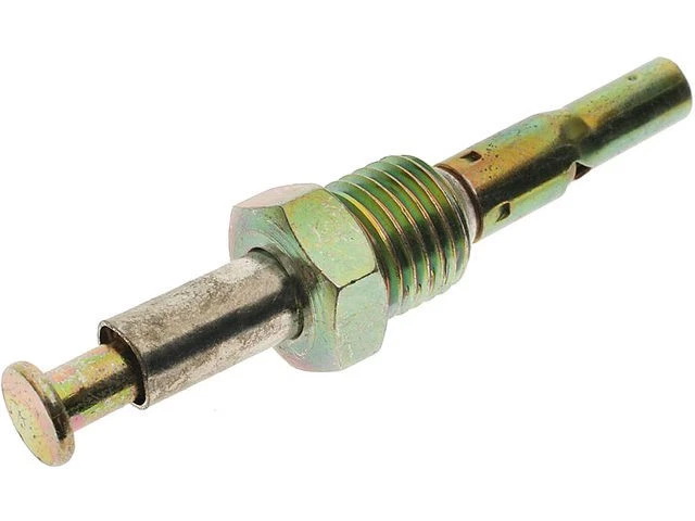

By the way the center pin (red or yellow) of the push switch should spin freely in the switch so you can what dadsbee said, hold the plunger with a plyer and then tighten the switch body into the piller.
Also the switches are self adjusting. After install you shut the door and the sleeve (green) presses into the threaded section to make the switch just the right length.
Use some tape to protect your paint.
Hold the plunger with a pair of needle nose or hemostats. Thread it in.
