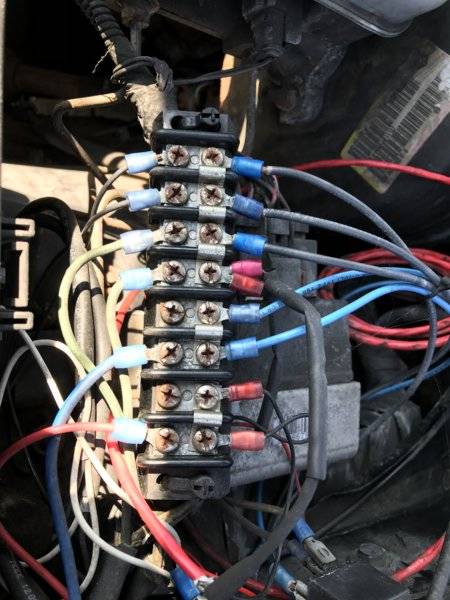

I ran everything thru 2 relays so I'd only have to run a small 3 conductor signal wire to switches in the cab.
These blocks are made of plastic so insulating is not a problem, mount anywhere.
Also links can be added ( see photo ) to make a buss.
