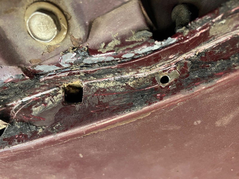

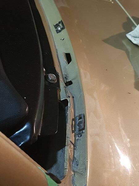

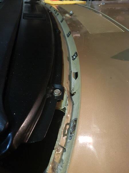

Heres a couple pics taken from pass side of our 67 cuda. You can see the small rectangular hole. I bet ours is now filled/plugged with goop lol
I’m guessing you mean the smaller holes near the long slots that have the 90* flap. I can see the long slots with the glass installed. I’ll see if I can see the smaller ones. I don’t remember if they were there or not.
Yes the smaller one, not the one with the tab/ledge.

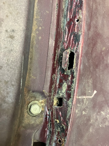

My drivers side was plugged right off. The pass side not so bad. But I cleaned them before I thought of taking pics. Bad habit of mine! Makes sense. Thank you Steve.

Makes sense.. My floors were gone, and cowl had issues. When I pulled the windshield, both drain holes were plugged. Drivers side was worse and had more damage. I'll be sure to leave them both open when reinstalling glass.
