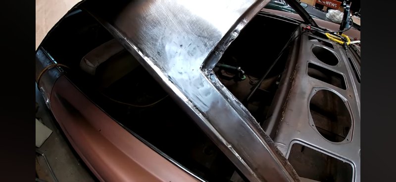

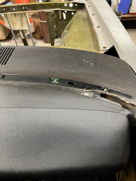

This is in reference to post #25. I took the windshield out today. The first two pics are the driver's side, taken through the windshield opening, the second two pics are the passenger side, also taken through the windshield opening.
In post #20, @Oldmanmopar clearly shows rectangular, or maybe square, drain holes. My car was apparently made without those holes. I tapped around with a center punch and a hammer, and there are no plugged up holes!
I guess I have to make my own.
I guess, I was lucky that my car apparently didn’t have a leak before I replaced the gasket!
I would think it would get rust in the channel just because the water sits there every time it gets wet, because it has no drain holes to let it out. I guess you would have to blow the channel out with air every time it gets wet to keep it from rusting.
My car was no beauty queen when I bought it, but it has very little rust. It must’ve been in a garage a lot even though it was pretty ugly. It’s been in the garage since I bought it in 2008.
I’m going to try to figure out exactly where to put a couple holes, I guess drilling would be OK.

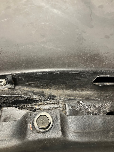

It looks like you may have the square holes there already, might be covered with lead or sealer? Attached a pic of my car for reference.
I was poking around with a center punch and a hammer. I'll extend my "poking around" range. You can't see the center punch marks because I took the pics before I poked around.

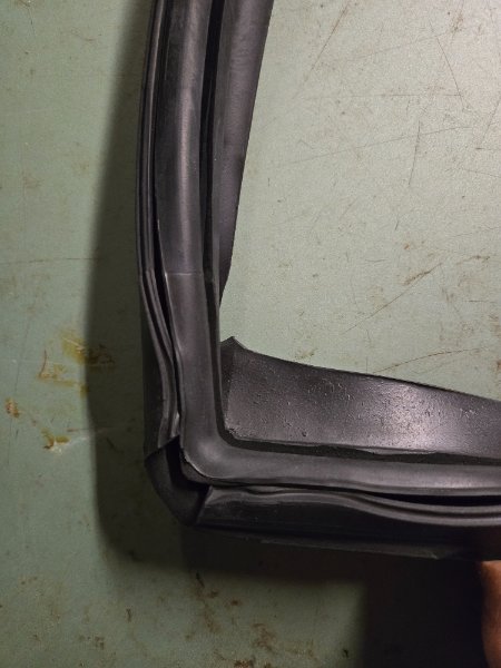

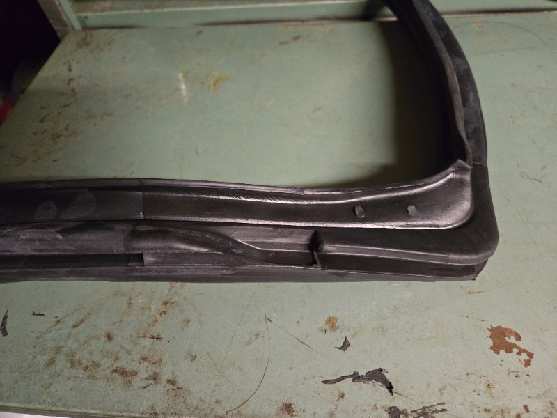

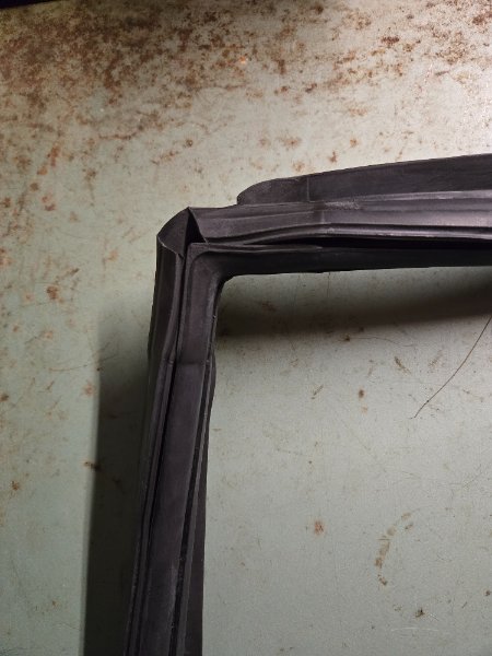

So, I went and opened my seal, WCR D690 for 68-72 A-body excluding Duster.
Exterior of gasket has a tongue and groove along the sides, and the top and bottom corners are completely open.
Any water that gets in will drain out the bottom corners.
The bottom of the gasket has a groove for the bottom rail between the cowl drain holes, separate from the rest of the gasket, last pic.
Problem is, there is no bottom raised rail on the car.
If water gets into the groove on the top/sides of the gasket, it appears the gasket directs that water to the cowl drain holes.
Why is there expectation that water will get into the groove on the top/sides of the seal, and therefore need to drain, but not into a useless bottom groove?
Why have a bottom groove that has no male counterpart?
Why design it so water can easily get under the bottom into that groove and have nowhere to drain?
With no sealant, it just looks like those drain holes could easily become overwhelmed.
I can see a faint outline of the hole! You have great eyes!
I punched around in that area (drivers side), and I can see what seems to be the hole. Whatever plugged it up is tough. I wouldn't want to hit the center punch as hard as I had to, if I wasn't pretty certain it was there. It's hard to open, but I suppose it doesn't have to be perfect. I think I have it located on the passenger side, too.

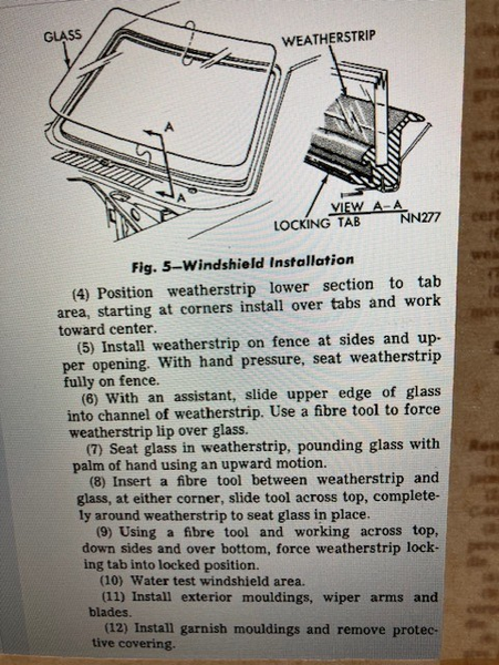

Here's the FSM way on how to do it. At least for the '73 and up Duster and Dart Sport. I imagine revised versions may be out there. This was on MyMopar.com.
What we've been calling the "pinch weld", they call the "fence". And I would add, that if you're using a new gasket, just cut the glass out with a razor knife. Otherwise, it seems cut and dried.
They use sealant, basically all the way around.

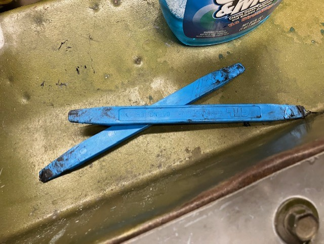

I laid the glass in position. Installing the top first, (per the FSM). didn't go well. You need to hold the glass up in the groove while working it in. That glass is HEAVY! I then started working each lower corner in. (Lots of dish soap and water, a long with spray window cleaner, both for lube.) I was done for the day with none of the glass started.
Over the next 2 days, I worked at it, and worked at it. Very tedious!
What a mess! I covered everything, and kept lacquer thinner (recommended solvent), and paper towels handy. Because it doesn't cure, you must wear clothes you can throw out! If it won't cure, it will always come off on something!

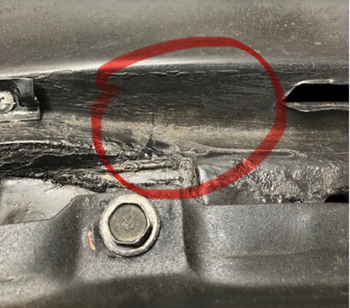

Anyway, BS aside. It's in, but there's a problem. The photo is of the top edge, looking from the driver's side, to the passenger side. The arrow points to the part of the gasket that's on the inside of the car. The gasket needs to be "pulled around". As it is, the groove that the lock strip goes in is up around the edge of the windshield, if that makes sense. It seems the sealer kept the gasket from seating properly as I went along getting the glass in it's groove. I done for the day again. I need to figure a way to get the gasket moved around. If that sealer had cured, I'd be screwed! As it is, I can work on it at my leisure. I sure ain't taking it out to reposition that gasket!
-Maybe someone could post a couple pictures of how it should look. I'd appreciate it.
