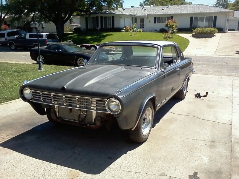

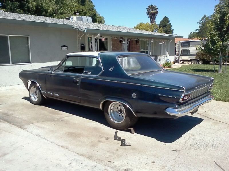

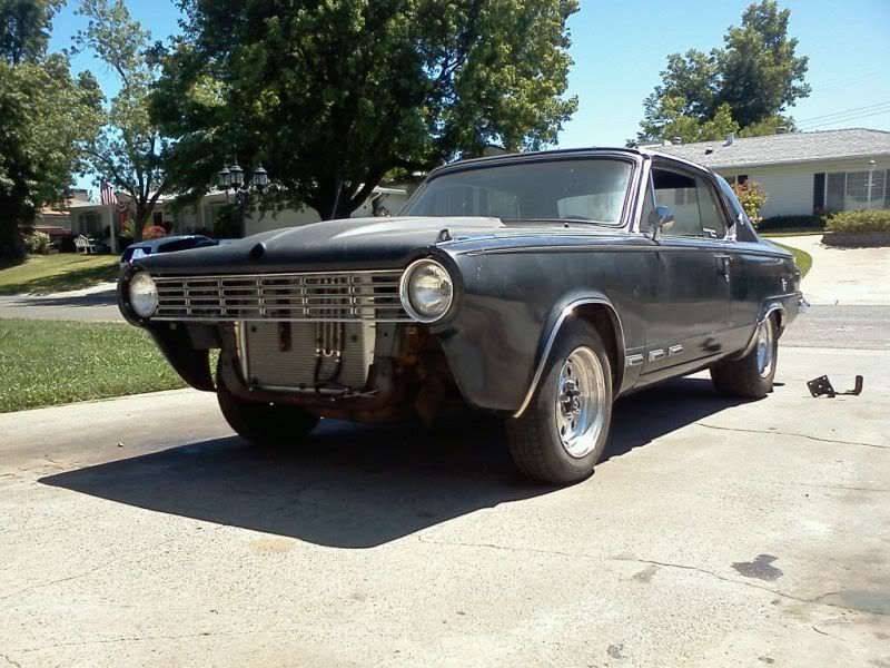

finally got the dart out of the garage!!
here are some pics
my dad bought a goodmark hood for his 67 chevelle, long story short it slid off the back of the truck and got messed up, so i cut the center out of it, cut the center out of a stock gt hood and welded it on, its all metal no glass
