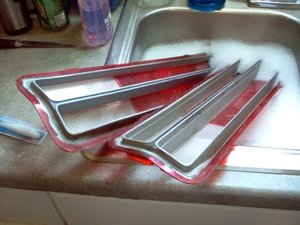

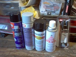

Got some supplies for Christmas and got to work on the tail light lenses!
These are for the grille, too!

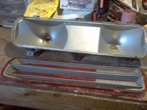

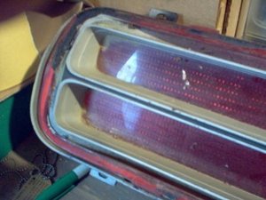

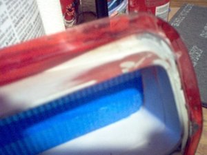

found a crack in one of the lenses. Just a small one, but still

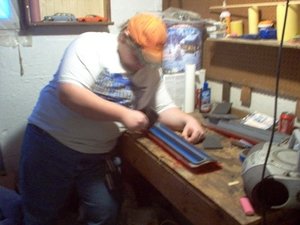

thanks to FABO! We Super Glued the crack and sanded it down once the glue was completely dry

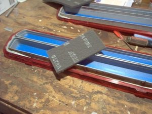

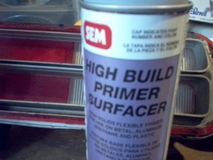

once the crack was sanded down, a little primer filler and sanded again

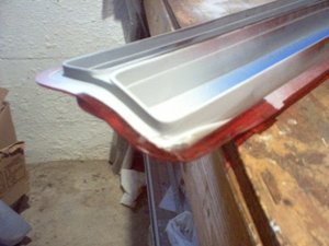

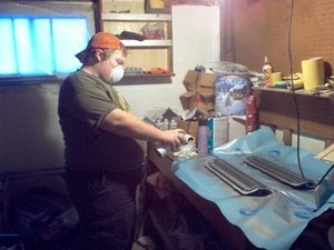

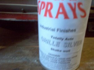

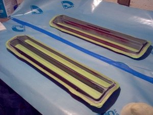

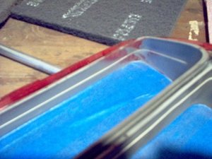

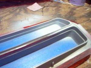

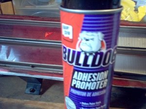

Totally Auto's spray bomb of grille silver
all masked up and ready to paint

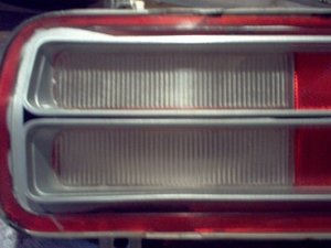

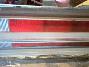

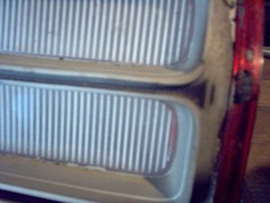

after letting the silver dry for about three weeks (we could no longer smell it) we could mask for the stripe
How the stripes turned out

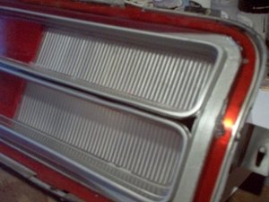

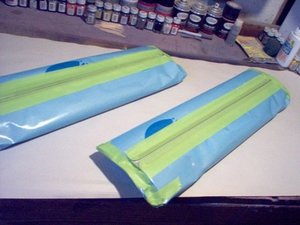

Just waiting for new seals and ready for a new tail light panel to put them into! :-D
There now wrapped up in bubble wrap waiting for the day.
