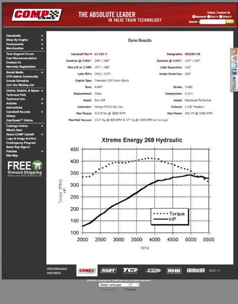

The 262h Comp made 12 extra horse but 6 less ft/lb when compared to a Hughes Whiplash on a stock 318.
here's the comp xe268 but in a warm sbc with dart heads.
i think the 262 has stronger numbers.This is comp cams own dyno sheet.
it peaks just below 5000 rpm
COMP Cams® - Xtreme Energy 268 Hydraulic Flat Tappet Camshaft, Part # 12-242-2 Dyno Sheet copy.jpg
...so for this "street only", low compression build, people are recommending cams with power bands that don't start until 1800 or 2000 RPM?
