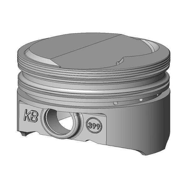

I recently found someone giving away a 318 for free so decided to pick it up, it’s got quite a bit of performance mods in it but I want to do some more, it has a set of ported and polished 360 heads, an unknown cam along with a 4 bbl intake, I want to add some kb 399 pistons and was looking for another opinion on that idea
399’s are domed. Therefor less decking of the heads required to have some decent compression. Measure the heads and use a compression calculator. Go for it
